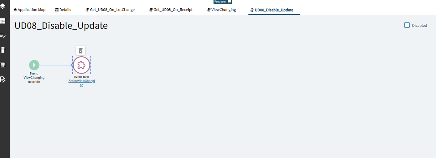

You can copy those events (right click on the event in the event list on the left in App Studio), then set the trigger to Event > Override and for Target input the name of the original/base event. You can then modify the copy and it will run that event over the base one.
Disclaimer: I do not know how much modifying you can actually do–at some point I’m sure you’ll break the app, depending on complexity/importance of the event; I’ve only ever added things to the end of one the base events this way

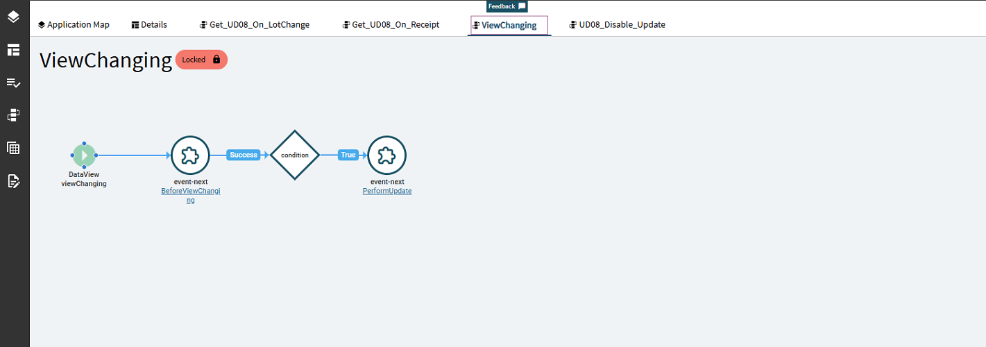

I only wanted to disable the auto update on viewchange, worked like a charm thanks David! Here is the copied event for anyone else who is a visual learner and is looking for an example.
vs base event
