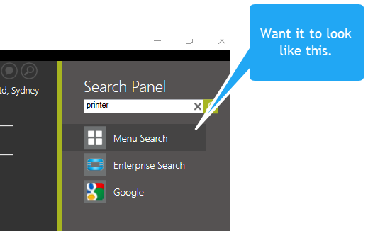

Hello,
Just wondering if anyone know of a way to default the order of the search panel to always have the menu search at the top?

Yea I figured it was locked in for now since I couldn’t find any type of fix. It is really annoying though. Hopefully Epicor gives us the option to change it in a later release?
