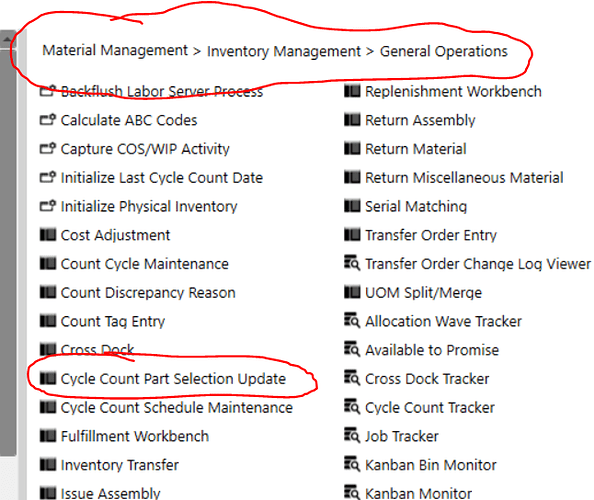

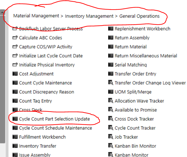

cycle count dtl records maybe. ive never seen that either. See if you have any open cycles.
Ok, how do I do that? I’ve never dealt with that before.
If you have had any cost adjustments, that will freeze your UOM as well.
@Will79 do you know Sql or have access to it?
if not you will need to do a BAQ to find the cycles where that part lives.
Yes, I do have access.
This will get you the Cycle year, month and cycleseq
from that you can find the part and remove it from the cycle. that should be all you need to do
