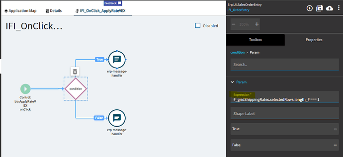

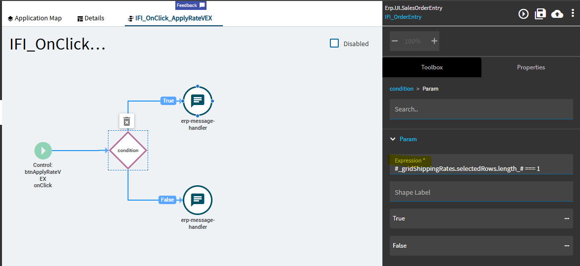

In App Studio, I created an event (Type=Control, Hook=On Click, Target=myApplybutton) starting with a condition widget with these Properties:
When I select a row in the grid then click my Apply button, I get the following error:
main.35e9416eee557e18.js:348 function body gridShippingRates.selectedRows.length thrown exception TypeError: Cannot read properties of undefined (reading 'length')

In condition > Param > Expression, I have also tried replacing ## with ~~ and with %…%. Both of those give me SyntaxError: Unexpected token ‘~’/‘%’, respectively.
I also tried using == 1 instead of === 1 on all of those but received same errors.

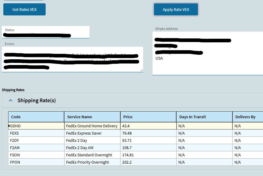

This is what my custom grid looks like:

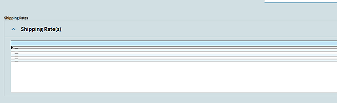

After adding the “Selected” column to my grid, my grid now looks like this after I populate the data view.

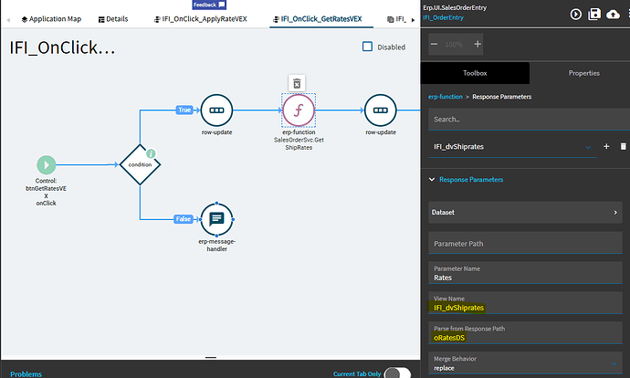

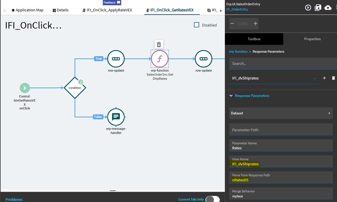

I think that’s because I didn’t explicitly define columns in my data view (originally) that’s bound to the grid. A dataset I’m returning from a function I wrote has the columns defined instead and it’s linked to my data view in the Response Parameters on the Function call.
So, do I need to go back to the data view and explicitly define all of my columns there so they will display correctly in the grid? I just want to follow best practices and also understand what and why I’m doing it.
