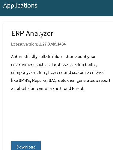

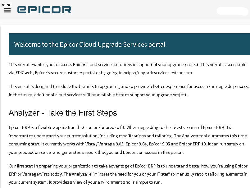

You need to download and run the ERP Analyzer from UpgradeServices portal.
https://upgradeservices.epicor.com/#/home
That will produce an online report of your current Epicor install, then go to the Customizations section and export the data as excel. There you will see what will work and what needs attention not only for UI components but everything else.
