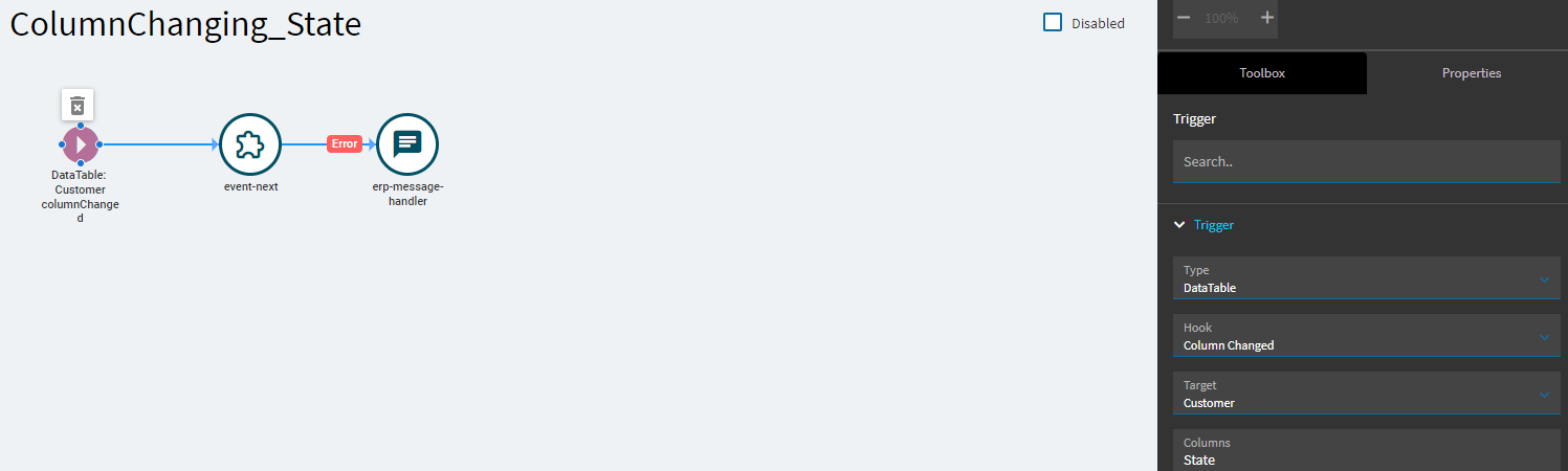

Bear with me. I’m learning Application Studio so sorry for any dumb questions, I have many :slight_smile:
I want to check the state field when they enter it to ensure that it is only two digits. We are on 2023 so I can’t use Pattern…sigh
I created an event, ColumnChangeing_State. Something I’m doing is not working right.
In the event-next I have the below JSON in the parameters
	"expression": {
		"left": {
			"path": "CustomerRow.State.Length"
		"operator": "Equal",
		"right": {
			"value": 2
Then the error message handler has

Hey Tammy, were you able to find a resolution to this? I am looking for the exact same solution.
I ended up creating a user codes for the drop-down state. When we upgrade to the next version, I’m going to revisit this.
