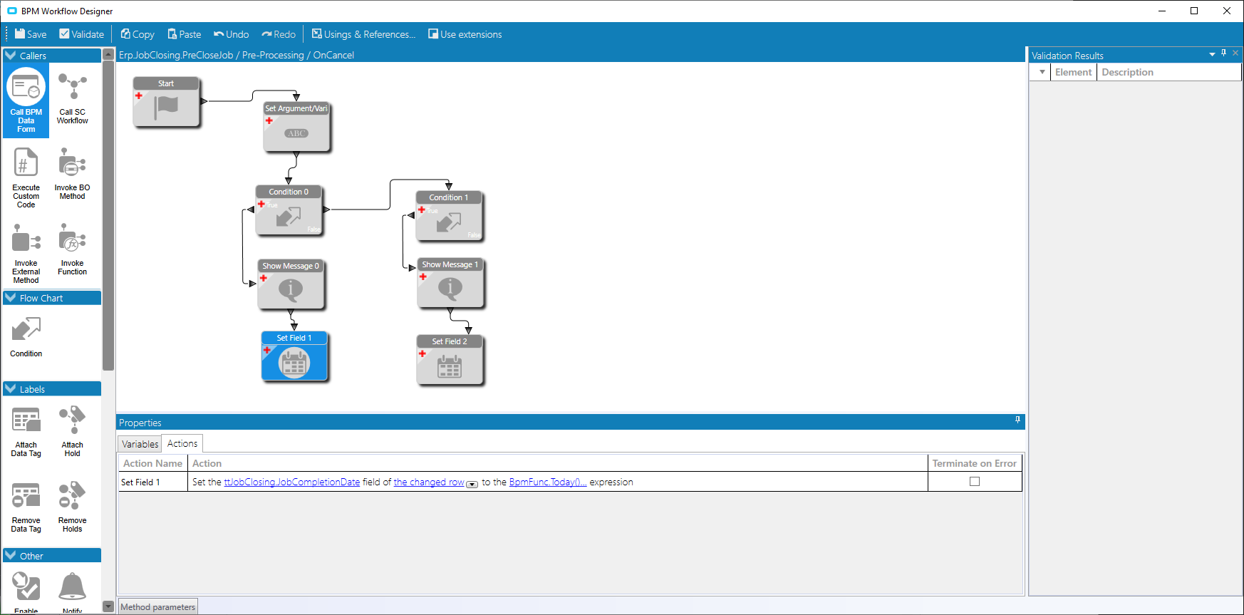

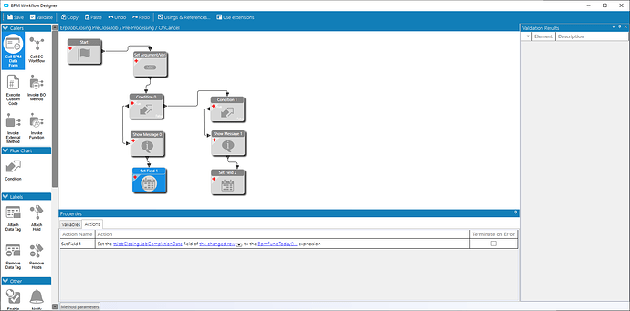

For some reason this Date field is stumping me. I gave up on trying to enable the CompletedDate field since it would never enable it (I did delete the form customization and only added the CheckChanged event but it still would not enable it). I am trying the BPM route. I have tried post and pre processing on the JobClosing.PreCloseJob event (see attached design). I traced the events when checking the completed box to get to the JobClosing.PreCloseJob event. In each case I was not able to get the date to save. I manually updated the jobHead when attempting post-processing and just setting the field in the pre-processing. I can see my messages come out with the proper data but it isnāt saving the data to the field or database.
Is there some sort of Epicor control that is stopping me from update the JobCompletedDate field?
