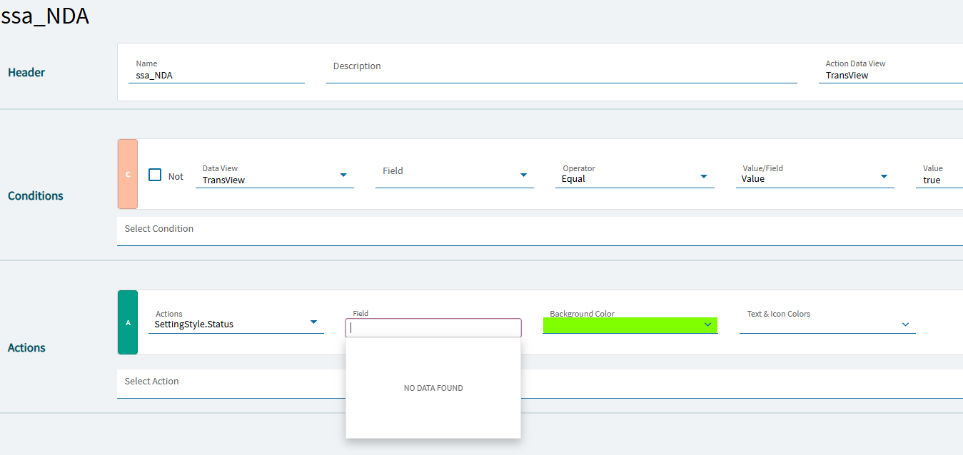

The field you put at the bottom of the rule is the binding field on the checkbox (the dataview is defined at the top of the rule). You can also use the rule to disable that field once the conditions are met. So when someone checks the box it could turn the text red and disable it so it can’t be unchecked.

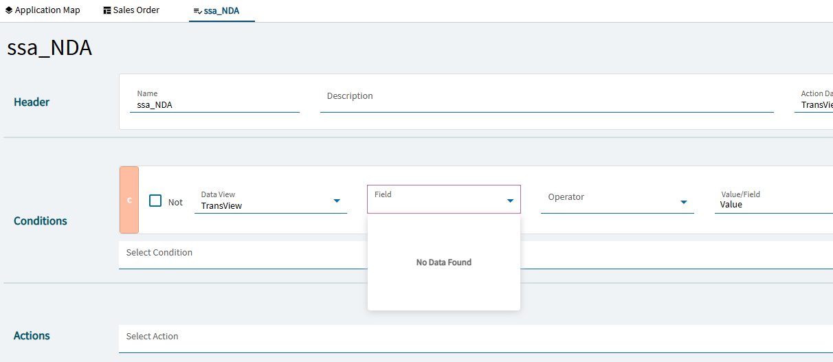

is it normal the field empty>?
For TransView yes that’s normal. The TransView dataview exists for on-the-fly binding. So you can set the epbinding of your checkbox to TransView.Checkbox and then you can just put Checkbox into that field. It will show “Checkbox +” right underneath, click that and then your rule will work. If your checkbox is already bound to another dataview, you’ll put that dataview in Action Data View at the top and then your field should be in the dropdown.

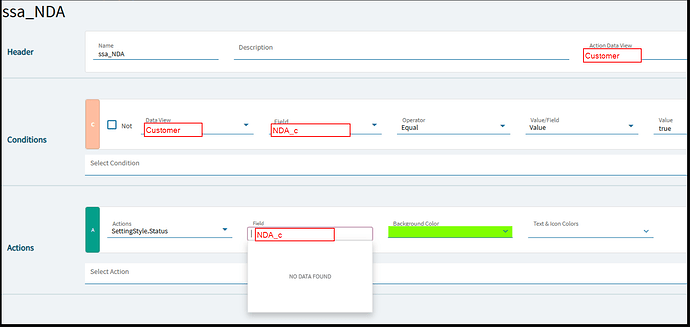

I have the checkbox value set on the table customer
i did this but decided not to use it coz it’s still editable. is there a way not to make this editable?
Try setting up your rule like this
this works!! Thank you Cory
