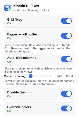

This extension aims to fix:
  • Grouping issues - Kinetic’s performance tanks when utilizing grouping above a certain number of rows (varies according to your computer’s hardware, browser, OS settings, etc.) - this mainly appears to be due to memory usage/leak/lack of GC.
  • Blank grid issues when scrolling
  • Grid “twitchiness” when scrolling (jumps up/down when clicking things)
  • Combo-Box popups requiring two clicks to actuate when the viewport width is <480px (combo box switches to use Kendo UI’s adaptive popup mode and fails to trigger actions the first click)
Added Stuff for funsies:

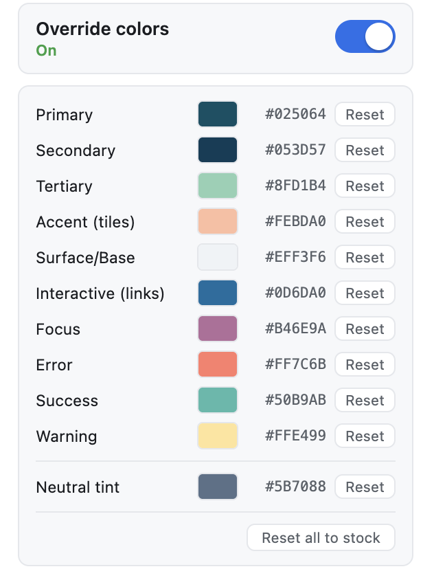

  • Disable theming

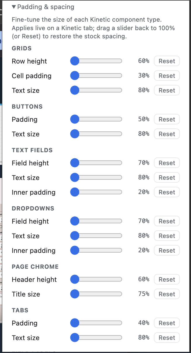

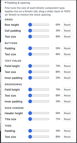

  • Choose specific colors

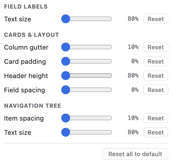

  • Fine-tune control padding / spacing - allow for larger font/text or smaller without scaling the browser zoom

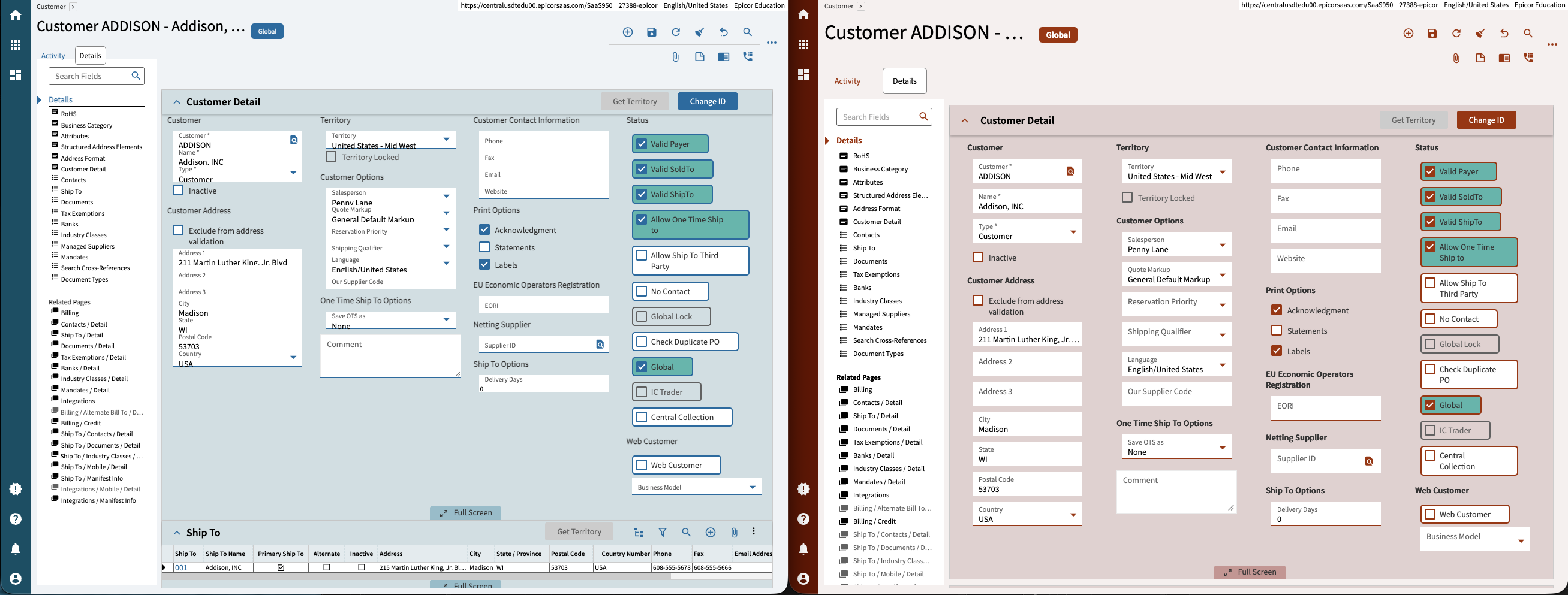

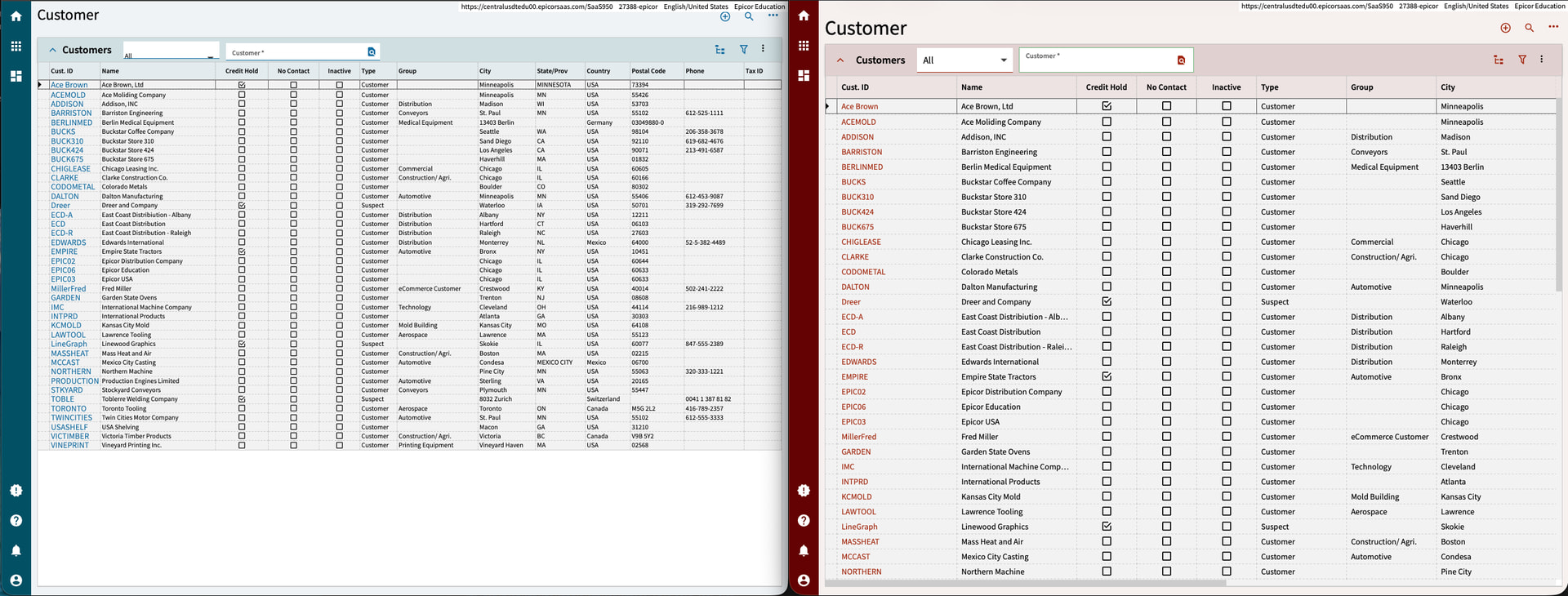

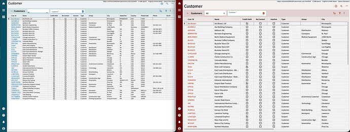

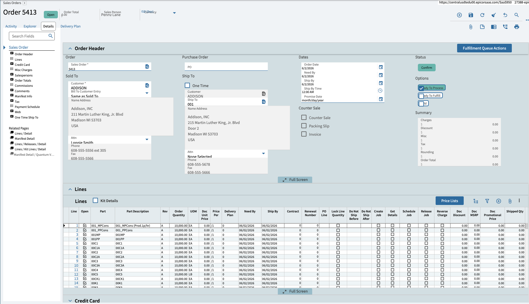

Screenshots with spacing/padding set to minimums, from Epicor Education (Left: With extension, Right: Stock)

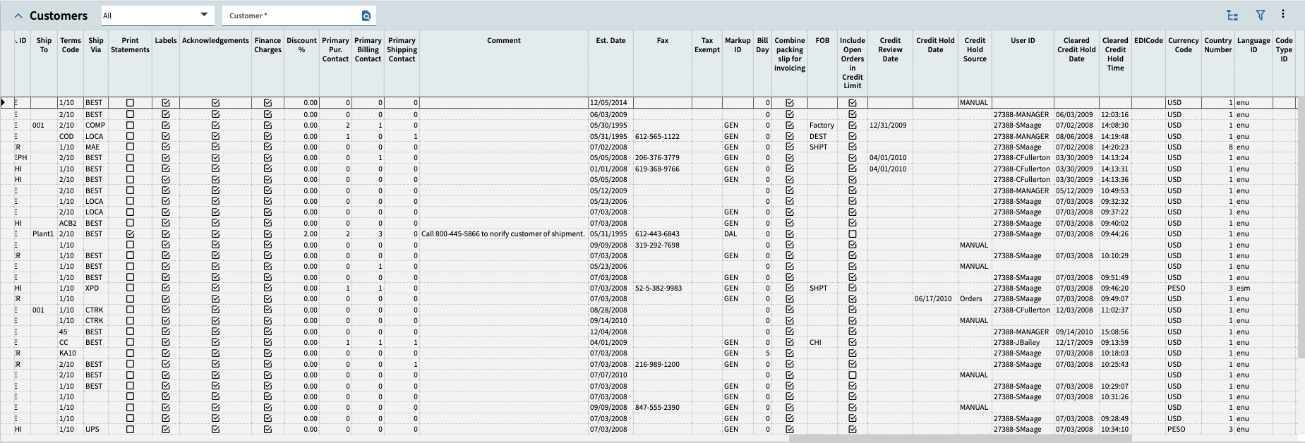

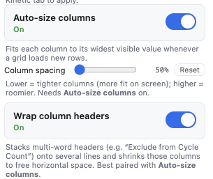

  • Created a toggle for multi-line column headers, which allows more information density in the grid in “minimum spacing” mode

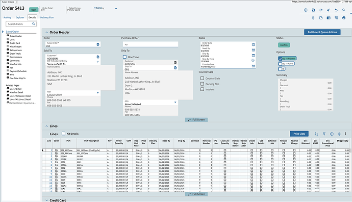

  • Adjust minimal padding mode to affect more Kinetic Components, adjust sizing/spacing at minimal to allow for more information density by auto-sizing text areas to fit content, making tags smaller, etc.:
Note: Looks like these changes to grid rendering broke the grouping fix (grouping doesn’t render now) - will fix tonight and build in a test script so it doesn’t break again!
Angry Bobs Burgers GIF
Hey, it got smaller! That’s all I asked the AI to do, not make it pretty!
I’ll fix that next version :stuck_out_tongue:
Hey I aint complaining about free work, I was just expressing my OCD
