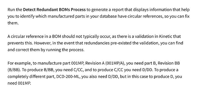

There is a built in process for this in Epicor
I ran this and it completed. Any idea where it puts results? It completed with no errors but the report detail and task log are empty.
