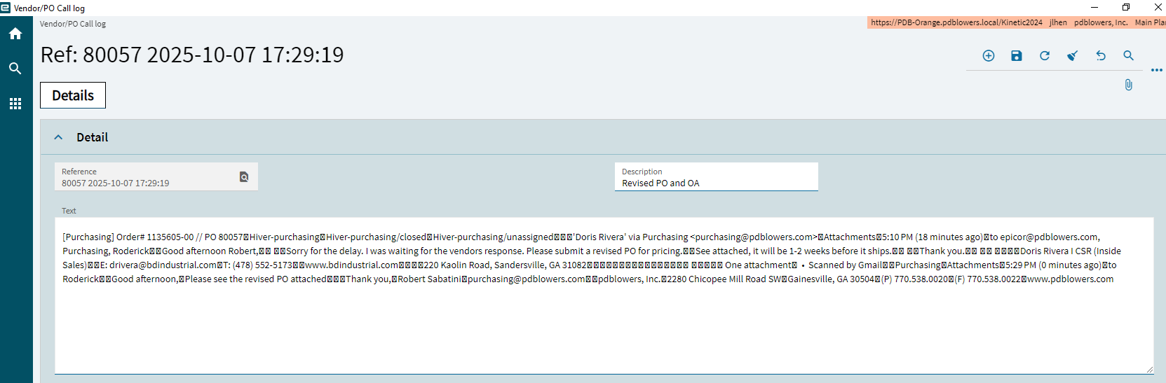

Classic form customization EpiTextBox to Kinetic Application Studio Erp-Text-Area displaying garbage instead of line feed, carriage return
Below are screen shots showing my issue.
Please help!
Thanks,
Richard

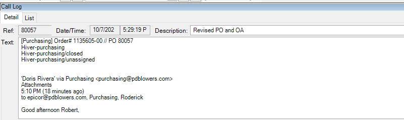

Classic text box definiton
Classic text box display data

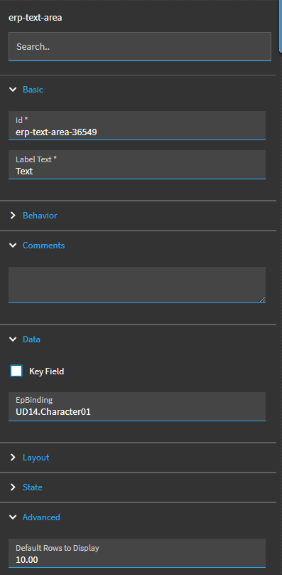

Kinetic Application Studio text box definition

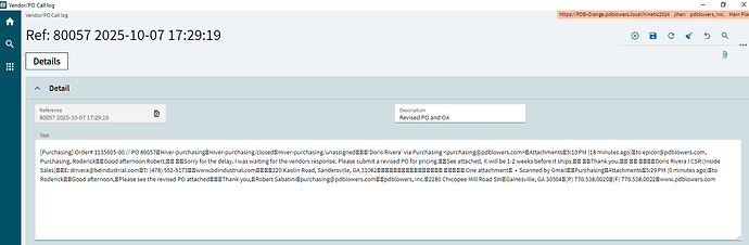

Kinetic Application Studio text box display data
Did you try using the rich text contol?
Thank you for your Reply.
I tried the Rich Text idea and it returned an empty box where line feeds are instead of the box with an X in it.
Anymore ideas?
Thanks,
Richard

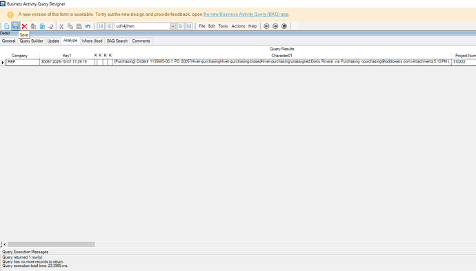

what is the actual data in that field, if you select it with a baq?
Thank you for you reply Alisa. Here is the baq results.
And if you put that in notepad to see the symbols?
I use clipboard viewer to see the actual characters (and codes).
Like the following shows the text I copied ends with
<CR><LF><sp><sp><sp><TAB><sp><CR><LF>
You might need CR and LF (and in a specific order) to show up like you want.
