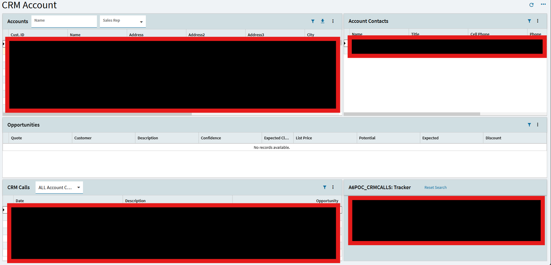

Showing you a replication of a classic dashboard layout
You must steer the users away from the assumption ‘it will work like classic’ it won’t and it’s not designed to.
