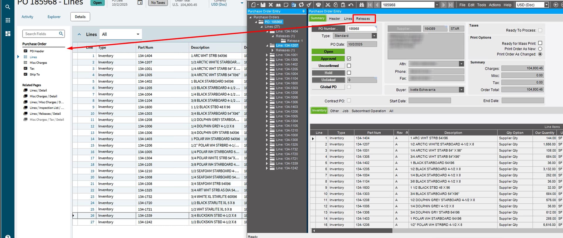

This is the path I take to get there. I am still I noob in Epicor so I hope we are talking about the same thing :sweat_smile:
Open the specific PO > the first Detail under Lines > Releases tab should be there.

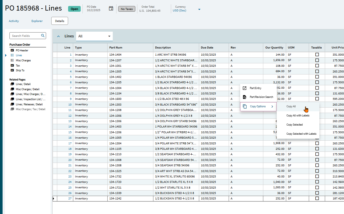

We are trying to copy all lines from one PO:
And pasting to another PO and get an error that a valid qty is required:

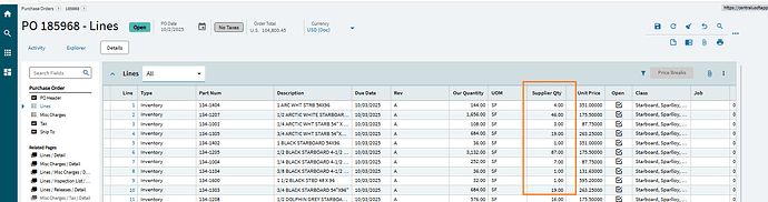

I think you have to choose the Supplier Qty when pasting and it calculates the Our Quantity. Expose the Supplier Qty and try again.

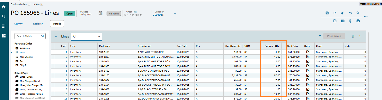

Mark - are you talking about adding the supplier qty column that I didn’t have turned on before?
If so, that did not work either. Maybe I’m not understanding what you mean when you say, Expose the Supplier Qty"?
Yes. But let me elaborate. When I add a new PO line for the detail screen, I can choose between Our Qty or Supplier Qty.
Maybe it’s currently set to Supplier Qty and won’t accept Our Qty. Maybe it’s not set at all and you’re not getting a helpful error message. :person_shrugging:
But I think this might be what’s stopping you here. You may be able to use Our Qty but will have to include that column in your paste. Yes, even though that didn’t exist before.

When pasting in Epicor, you need to be sure the columns are in the same order and I would also suggest only pasting the bare minimum of columns. In the simplest terms, you copy from the same grid that you are pasting into. If you are copying from the summary lines, don’t paste into the detail lines, for example.
I just fired up the vanilla PO form and could copy and paste lines in both the classic version and the kinetic version of the form. Any UI customizations, BPM’s etc?
