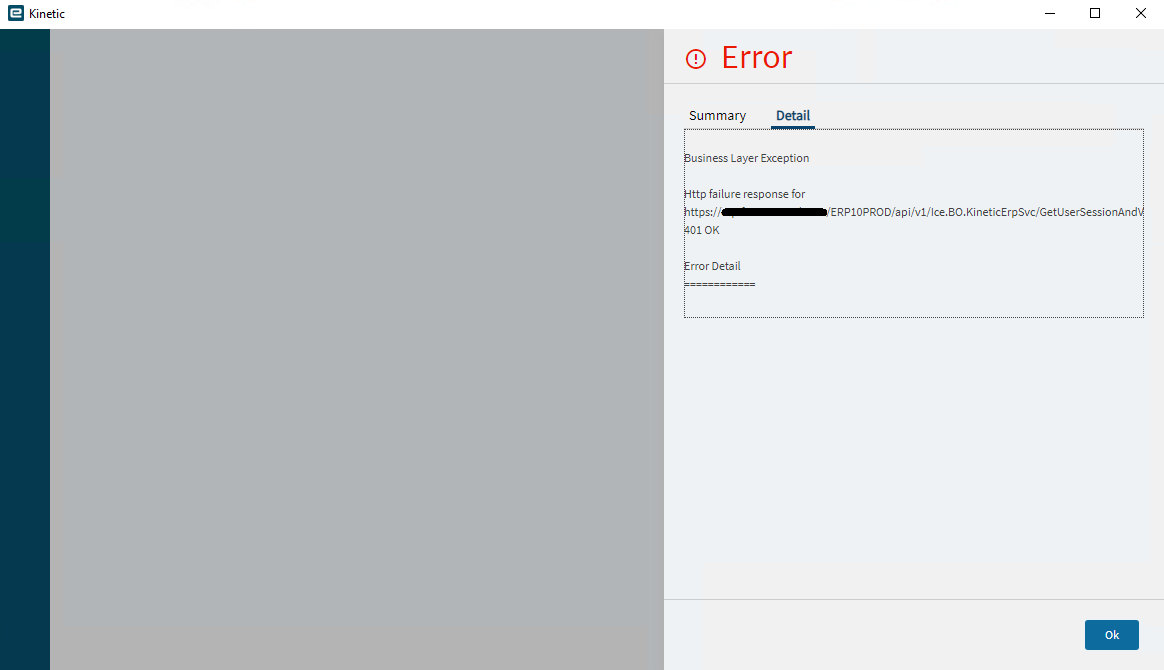

To our problem, when we install the client app, the option to launch classic/modern/kinetic no longer exists. Right now, after entering in a user/pw, it looks like it’s trying to launch a kinetic menu, but then times out with an error. Should the environment be going to classic or do we need to do something to force it?
There is no more Classic home screen like you are used to, from at least 2024.1 onward the home screen is Kinetic. You can set menu items to then launch classic but the launcher/home screen itself is kinetic.
I’m not sure about the specific error, when you launch it on your server with the manager account does it launch?

Yes, it will launch correctly from the server. After playing around, seems as with most everything, I had a DNS problem. Even though I have a forward lookup in the sandbox domain controller, it seems the server and clients want to do a random number generator and go back and forth between the local and public IP. Added entries in the hosts file on a client and the server and now I can launch the environment reliably on any of the sandbox machines.
