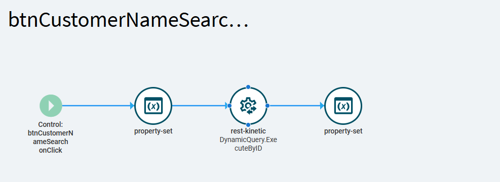

Upgrading an old heavily customized dashboard.
Top grid can be populated from different BAQs, literally for dynamic purposes, which then other grids subscribe to.
Is it possible to do so in Kinetic? I am able bind it to empty dataview and getting results correctly from first BAQ, but the problem I am facing is not being able to clear it properly anymore. List of columns stays there:
I have used data-clear, dataview-clear, property-set widgets…but no avail.
Anyone faced similar problem?
For anyone finding this post in future, solution is not to use both Function NOR Kinetic-BAQ widgets for this purpose, but get data from Rest-Erp widget instead. It does work properly then.
