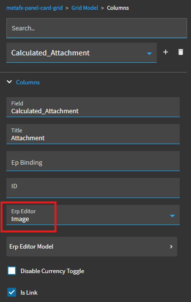

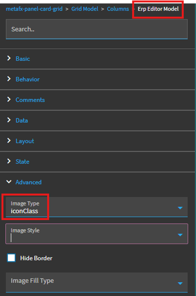

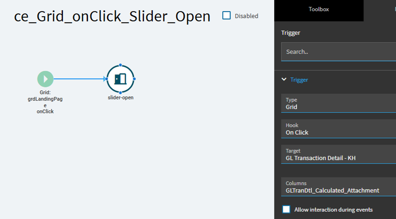

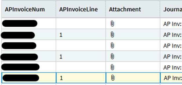

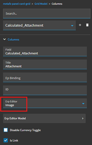

In a dashboard grid cell, I was able to show paperclip icon. The grid column containing the icon is set as Link and I have a grid click on even which opens a slider. The slider page shows another grid with attachments information.

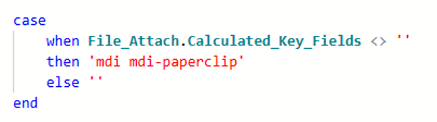

When I click on the icon the grid click on event is not triggered at all. When I remove the icon and the cell is showing the calculated field “mdi mdi-paperclip” as a link then the slider opens. What am I doing wrong?

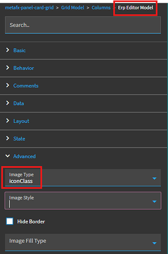

I played around and couldn’t get it to work either. My best guess is that once the column is set to Image in the Erp Editor, the “is link” property gets ignored. Notice the paperclips are black, and not blue like typical text links.
I think your best bet (unfortunately) is to display the word “Attachments” or “Attach” instead of the icon.
The rest of your process works… its just that an image doesn’t appear to be supported with the “Is Link” property.
