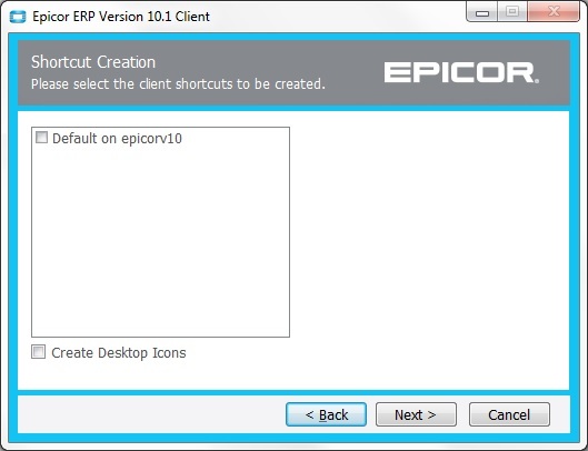

# Client Shortcut Installation **Category:** [Epicor ERP 10](https://www.epiusers.help/c/e10/5) **Created:** 2016-12-22 19:16 UTC **Views:** 1866 **Replies:** 4 **URL:** https://www.epiusers.help/t/client-shortcut-installation/36711 --- ## Post #1 by @bmgarver E10.1.500.9 Trying to install the E10 Client on a workstation, but the shortcut for the Epicor10 application does not show in the list. Only default on EpicorV10 is available to select. Client is running Win 7 Pro and belongs to the domain. User logged in is a member of Domain Users and IIS_USRS. I have another workstation running Win 10 Pro that is not experiencing this issue. Any ideas? Could this be a permission issue? --- ## Post #2 by @josecgomez [quote="bmgarver, post:1, topic:36711"] the shortcut for the Epicor10 application does not show in the list [/quote] What list? --- ## Post #3 by @bmgarver Shortcut Creation during client installation Epicor10.sysconfig file is in the Client/config folder and should be available to select in the above list. Thanks, Brian M. Garver Northern Concrete Pipe, Inc. --- ## Post #4 by @josecgomez Check the permissions o the Epicor10 file.. make sure somehow it didn't get super protected --- ## Post #5 by @bmgarver The Epicor10.sysconfig file has read&execute and read permissions for Domain Users. These were inherited from the deployment folder. --- **Canonical:** https://www.epiusers.help/t/client-shortcut-installation/36711 **Original content:** https://www.epiusers.help/t/client-shortcut-installation/36711
