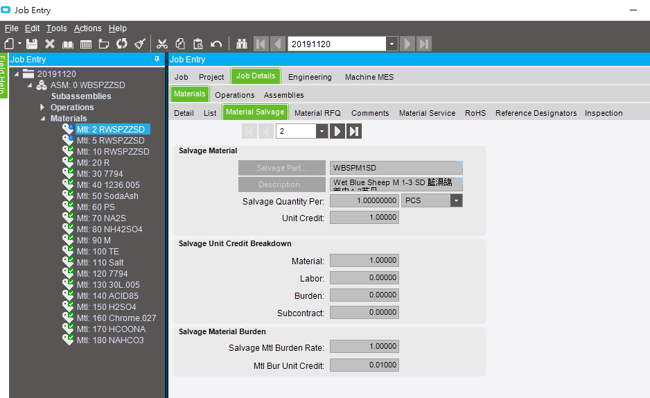

I have already set the cost on the job as following picture.
But when I complete the job receveipt of salvage part, the cost can not be shown on the Inventory WIP Reconciliation Report. If I need to set up another special procedure?
