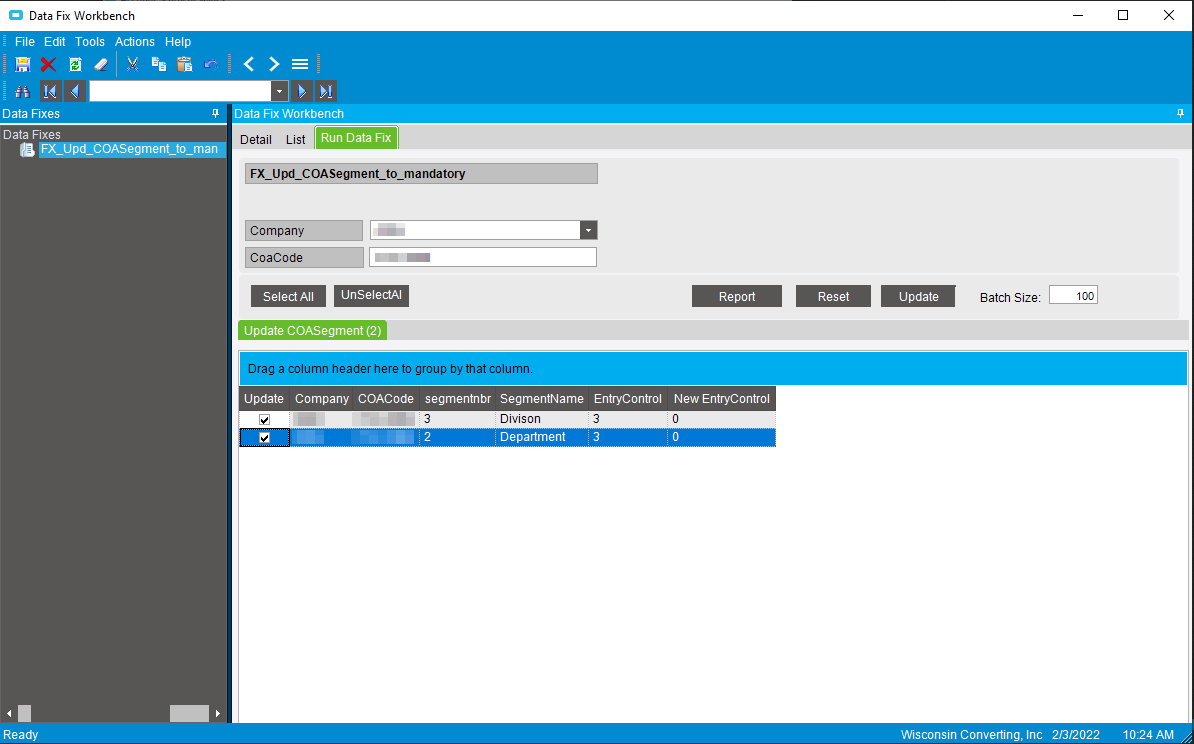

We have COA segments that are optional that should be mandatory. Any “approved” way of converting them. Not a maintainable field natively.

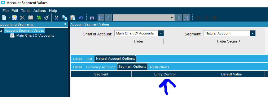

May be a work around, you can select the segment as mandatory in the Account segment values.
@gpayne for kicks I did test just jamming Mandatory on my COA segments in SQL and it did work preventing me from creating an account without all 3 of our segments. That with lots of testing will be my last resort knowing there is a level of success there.
@prash172 I will look into that further as well.

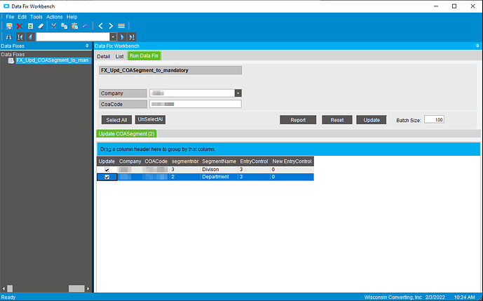

Epicor has a datafix for this that they will be sending me. No harm no foul.
cr31440mps_10_2_600_26_sql.zip
