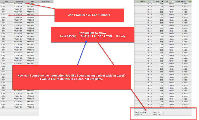

Hello everyone,
I am looking for some guidance.
I would like to combine information
as I have in the picture.
Job # 243584 Produced 39 lots with a total of 74,617.14 #, 37.31 Tons .
I can do this in excel easily using a pivot table. I want to keep everything in Epicor.
I appreciate everyone suggestions.
Thank you.

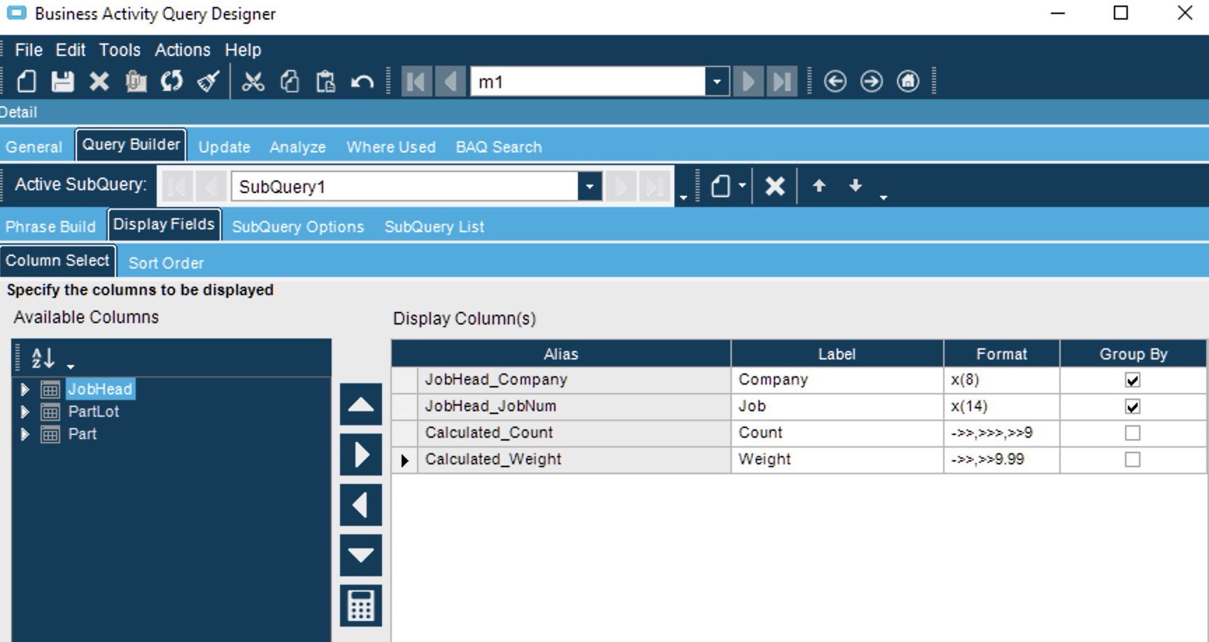

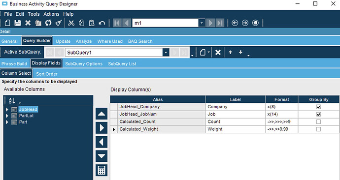

It seems like that would be fairly simple, though I could be wrong :slight_smile:
In the BAQ, you’d just join the tables, group by the job and in calculated fields do the Count and Sum operations:
