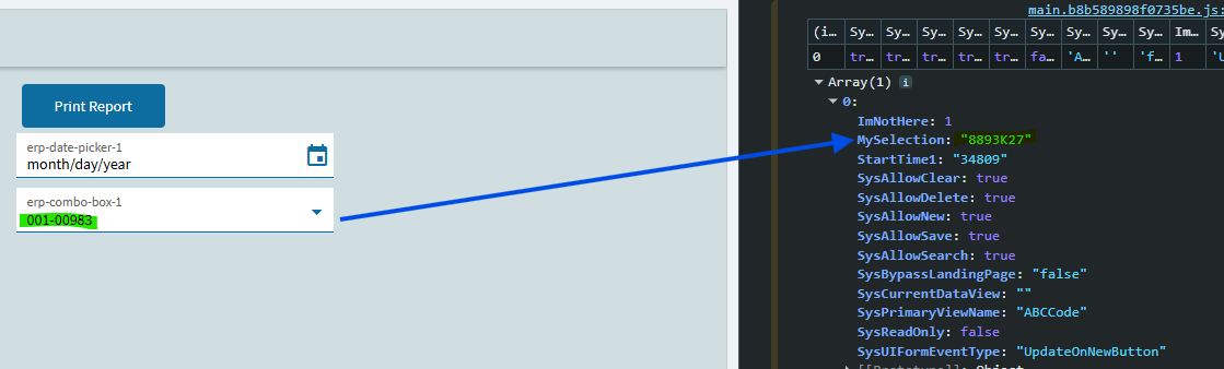

I bound my combobox to TransView.MySelection:
Preview:
You can see my Text Field (UD02_Key1) is a part number I’m selecting in the combo.
My VALUE (UD02_Key5) is being passed to TransView.MySelection.
… and again, this combobox only had those (3) settings/properties set-up.
