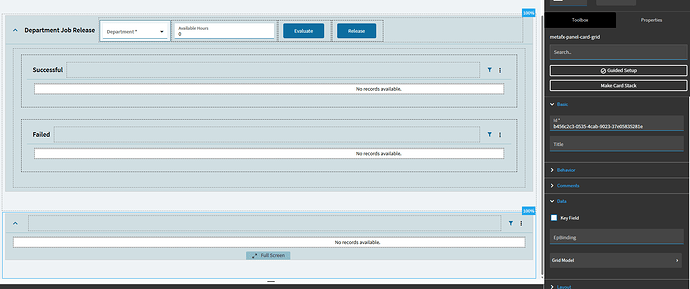

This is my dashboard layout

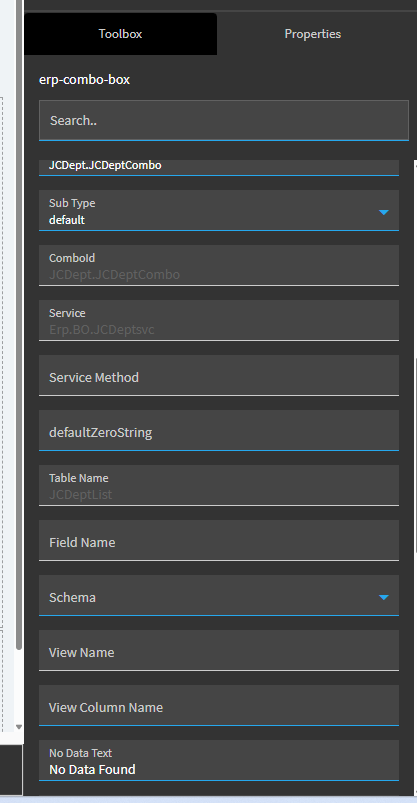

The Department combo box is in a panel card (not Panel Card Grid), these are my inputs for the combo box

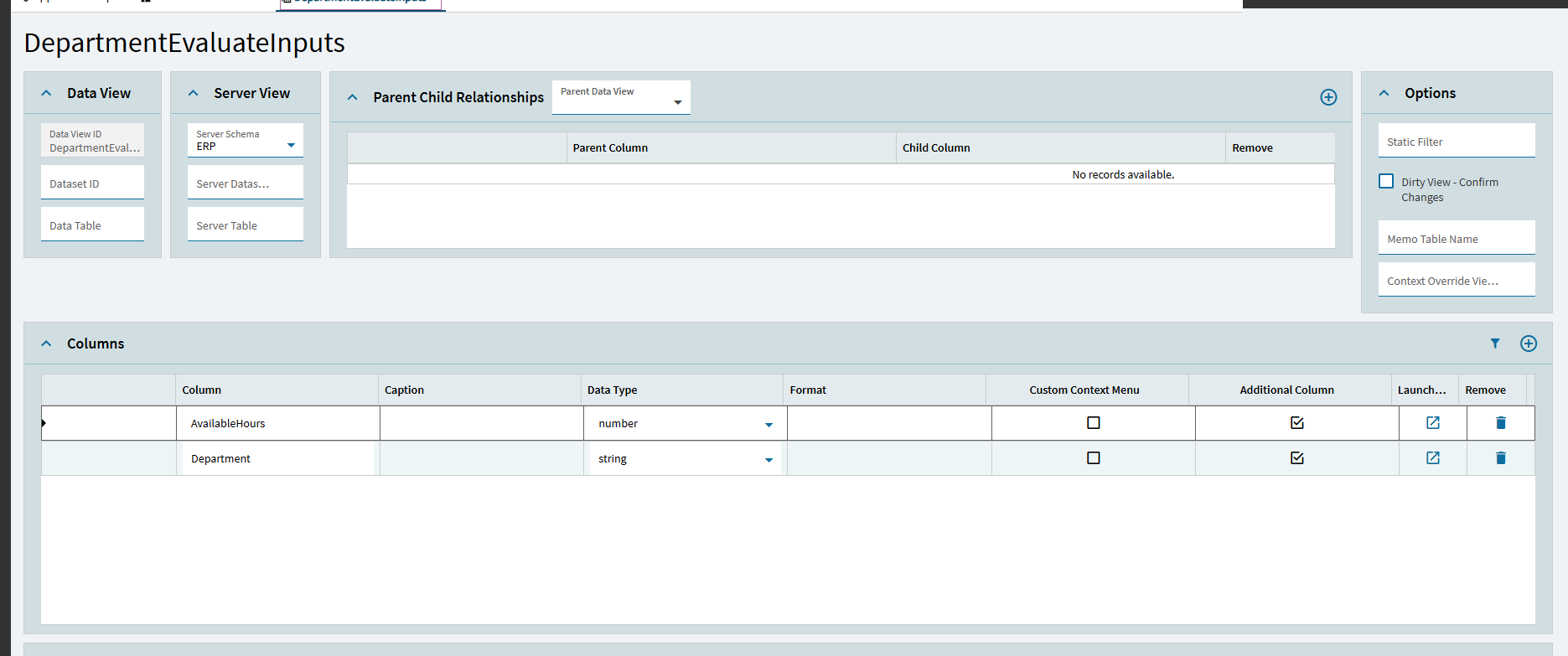

These are the inputs on my grid at the bottom of the dashboard

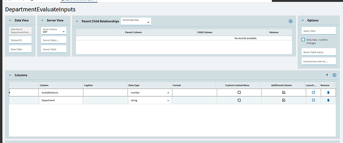

This is my view
