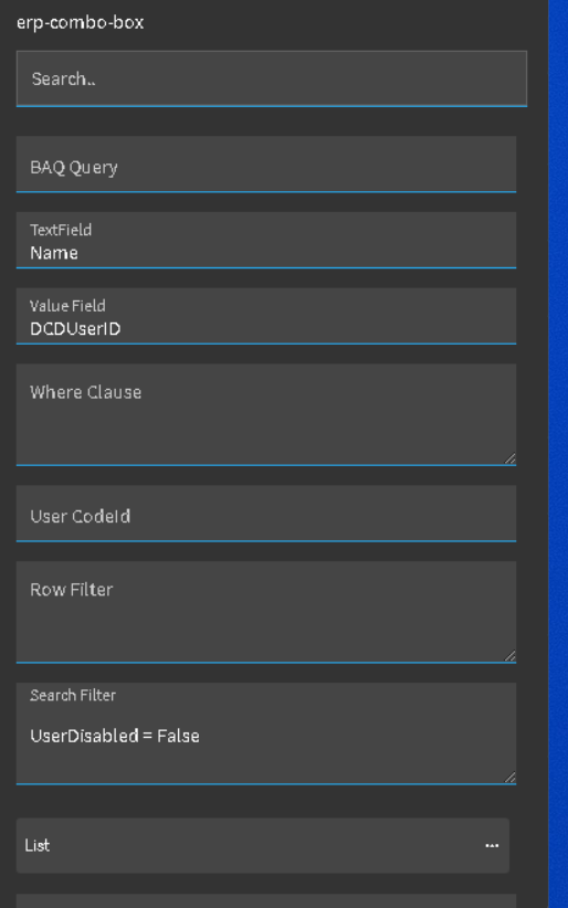

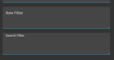

Hey,
I have a combobox connected to ResourceGroup displaying correctly, except I want to filter out inactive groups.
The reusable resource group combo wouldn’t let me change the Filters contents, so I added another combobox and manually entered the service, etc. Works fine, except for the filter.

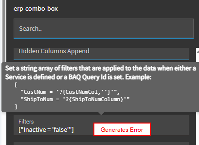

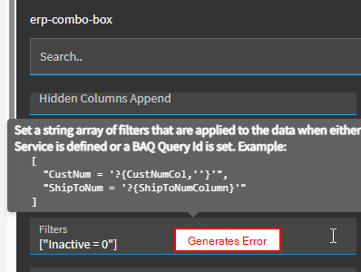

When I try to add the filter like this:
Or this:
Or any other permutation, I get this when I click on the dropdown:
What’s the syntax on this bit of code? I’ve also tried these filters with resulting errors or lack of actual filtering.

Well, this worked. Close enough.

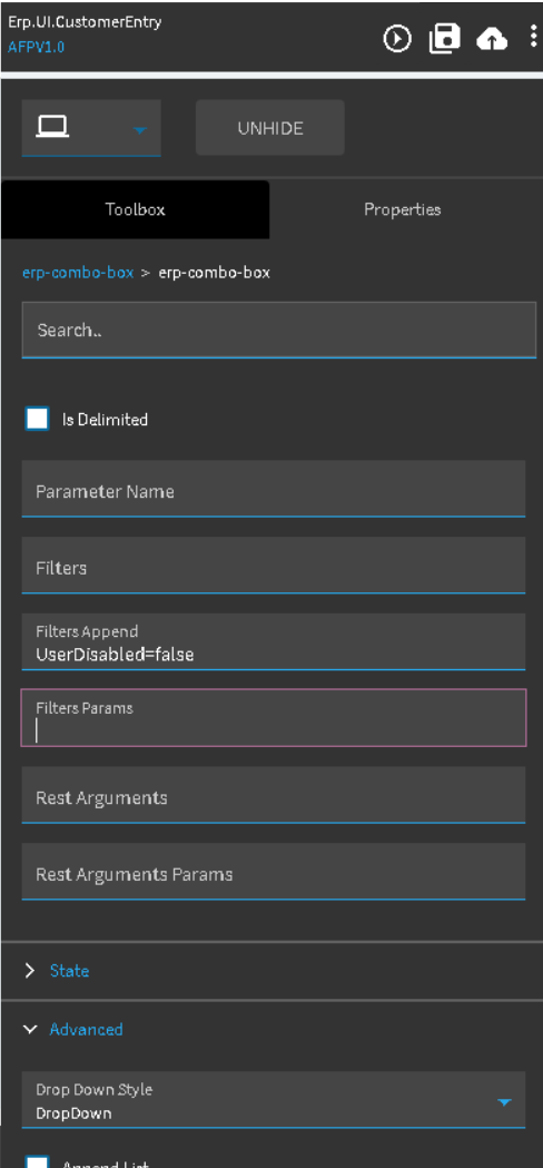

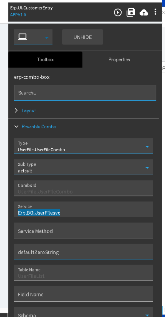

I am trying to do something similar - my reusable combo is using the Erp.BO.UserFileSvc - GetRows table UserFile.
I am trying to filter by UserFile.UserDisabled = false and I cannot get the filter to work.
Any suggestions welcome:

Put it in the Filters Append section.

DaveOlender:
Do you need the GetRows method?
I can get this working with GetList, but if I use GetRows, it complains about possible SQL injection.
Ms. Hannah: Thank you for the suggestion.
It is working now but i am not sure why.
I noticed that the Reusable combo - Type and SubType were blank. So i reset those fields.
I then noticed that the “Is Delimited” checkbox was checked. I then just left the Filters Append as “UserDisabled=False” and it now works.

That’s because when you use the Type and SubType it defaults to GetList.
