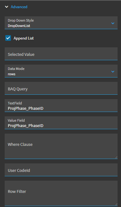

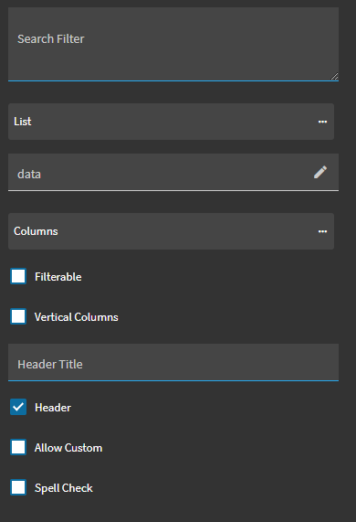

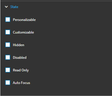

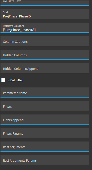

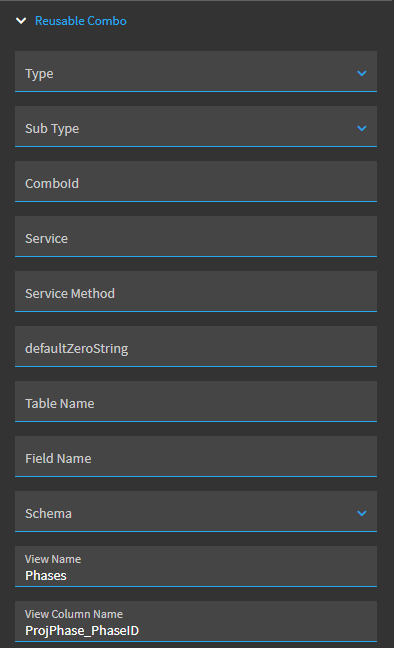

Below are some screenshots of the Combobox settings.
Phases = Source Dataview
ProjPhase_PhaseID = Column in Source Dataview I want to display as options
You might try to start with the minimum to get it working:
In this case, the minimum for a data view combo is the View Name, TextField, and Value Field…
If that pulls what you expect, then add in your sort and that should be enough for a basic combo
I’m just thinking that there is a lot of extra stuff that you shouldn’t need - and it might be confusing things

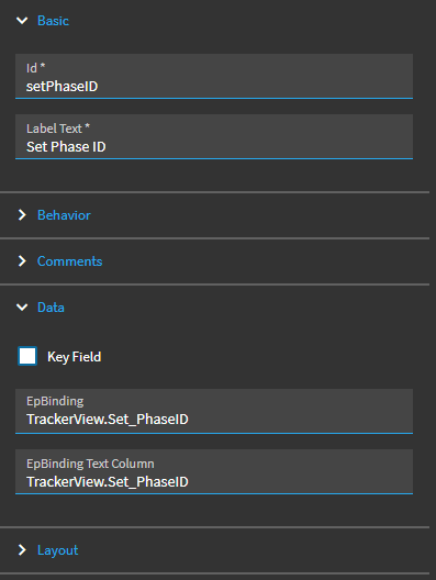

Ah, that did it, thank you!
I needed to fill in EpBinding as well or the dropdown was greyed out, but otherwise those three got me what I wanted.
Thank you, appreciate the help!

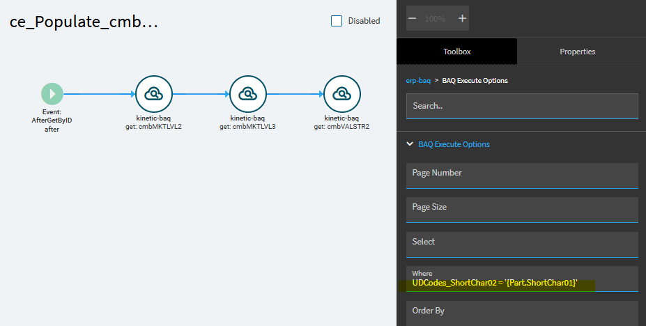

My problem now is that the combo is not populating when loading, but as soon as I click on it, it’s showing the correct data.
Below are the combo box setup and results screenshots:
Try adding CodeDesc to your Retrieve Columns property. See if that will get it to display when it is first loaded.
Thanks David,
Populating the Retrieve Column with UserCodes_CodeDesc did not have any effect at all.
It helps not to give up, I finally was able to make the combo boxes to populate correctly.
