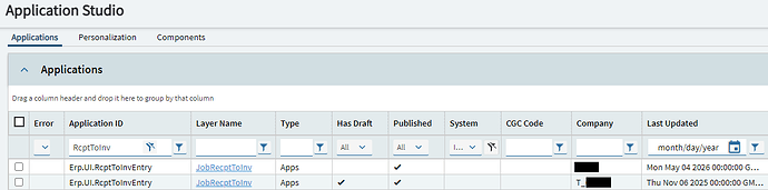

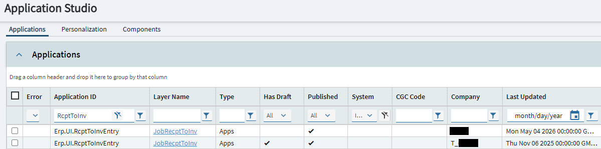

First layer is on the Job Receipt to Inventory (Erp.UI.RcptToInvEntry). When I pull up application Studio, I’m seeing two entries here for the same layer: one is owned by T_99999 but has a last updated date from last year. The one that was put into production earlier this month is owned by a specific company. When I go into menu maintenance, the layer only shows up once (makes sense). And, when I run in any other company, I get this layer with it’s customizations on it (that’s what we want). So, other than having two layers show up in Application Studio, doesn’t seem to be causing any problems.

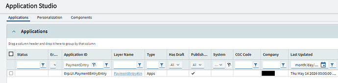

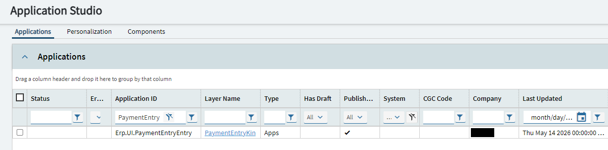

The second layer is on Payment Entry. On this layer, it’s ONLY SHOWING the layer owned by the specific company. There is not a second layer out there owned by T_99999. On this one, I’ve got the menu item pointing to the layer, and the menu item is checked for “All Companies”. However, when I run Payment Entry in any of the other companies besides the one owned by this customization, I don’t see the layer running. I only get the base.

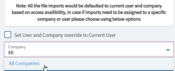

If nothing else, you can export it, delete it, then when you re-import make sure to pick all companies.
