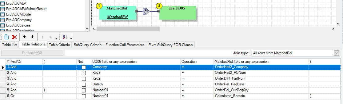

I am working on a BAQ to compare open releases in Epicor to a customer data file in a UD table. There are two important elements to the query.
  1. UD05 table containing a list of parts, dates, and quantities. These represent releases the customer wishes to have open. Key fields: Part number, PO number, Date, Qty.
  2. A subquery consisting of OrderHed>OrderDtl>OrderRel. I placed criteria on each table to pull only open orders, lines, and releases. OrderHed also has criteria to filter only the orders for the specific customer number I need. Key fields: Part, PO, ReqDate, OurReqQty, OurRemainQty.
The goal of the BAQ is to show sales order releases in Epicor that do not match orders in the UD05 table.
Here is the BAQ:
The top level query has a subquery criteria: “UD05.Key1 Is Null”
All together this shows me open releases in our system that do not match releases the customer has requested. This works alright, but the more astute of you may notice there is a bit of a problem with this approach.
Problem
If our system has two (or more) releases for the same date and quantity, and the customer file only has one release for that data and quantity, this query does not show the ‘extra’ release in our system.
Approach
I need to find a way to allow the BAQ to match the first order in our system, and then any subsequent orders would not match because a match has already been found. Anything that doesn’t match should be listed in the final BAQ. Technically the dates and quantity will still match, but I need some other flag to say that the data/qty has already been accounted for.
I think the answer has something to do with aggregates and the min function, but I just can’t figure it out.
I am open to any ideas. Thank you for taking time to read this!
