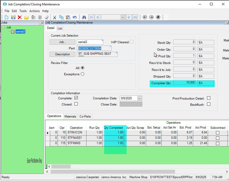

I’m scratching my head on this one. Has anyone seen this before?
Either I’m having a “duh” moment, or something strange is happening here.
Why does the Complete Qty field show 10,000 completed, while the operation details below clearly show only 1 completed per op?

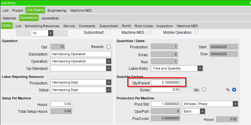

Look for Qty/Parent on the operations or the assembly - if I set that to 0.1, I can replicate your issue. It should be 1
Interesting, I have never seen that, but you are correct! The operations were set at .0001 and I went in to change to qty 1 and re-completed the job. Qty showing complete is now correct. Thank you!
