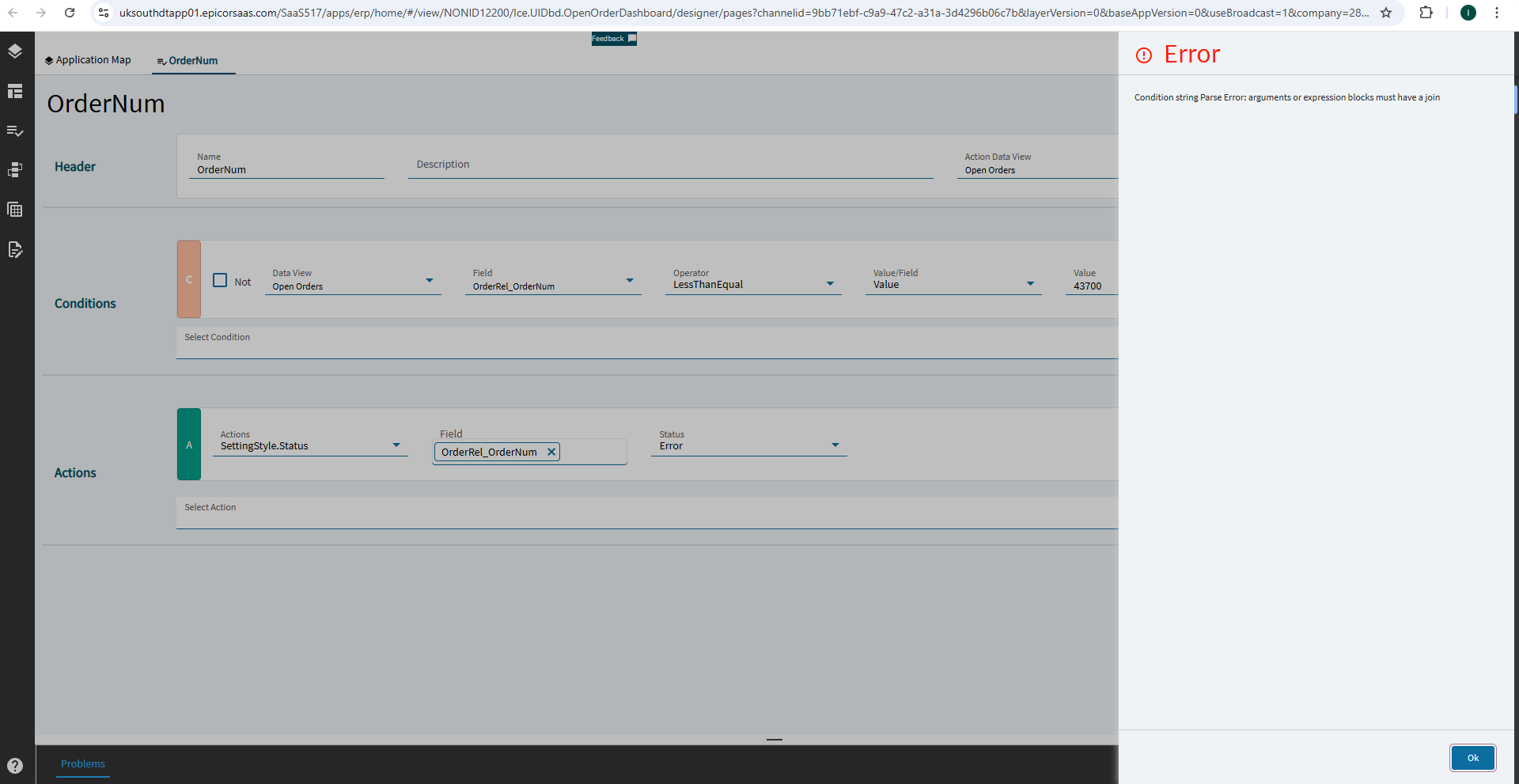

Condition string parse error
Anybody now what this error is and how to get around it. I am trying to set a rule.
Could it possibly have something to do with their being a space in field name. If that’s the case, then I would think this is a bug.
I think it is the spaces because I was able to create the same rule for a field without spaces. This is a bog that should be reported to epicor.

Condition string Parse Error: arguments or expression blocks must have a join

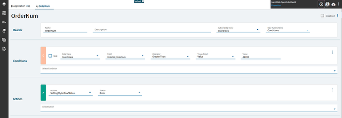

Spaces in dataview names will also generate this error!
Space in dataview (Open Orders) = Error:
No space in dataview (OpenOrders) = No error:
