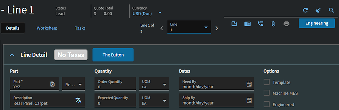

I have an app layer for quotes that can be launched from two different menus: Quote Entry and Quote Tracker. On the quote detail page, I want to add a button—preferably an action data button—that displays a message or performs a similar action.
The button should only be visible when the selected quote line has a specific part number, for example, XYZ. It also needs to be clickable regardless of whether the user opened the quote through Quote Entry or Quote Tracker.

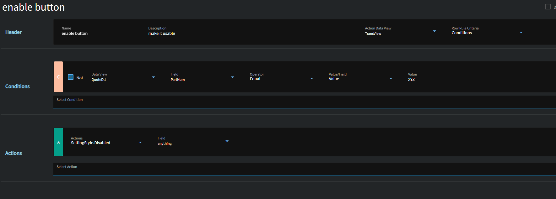

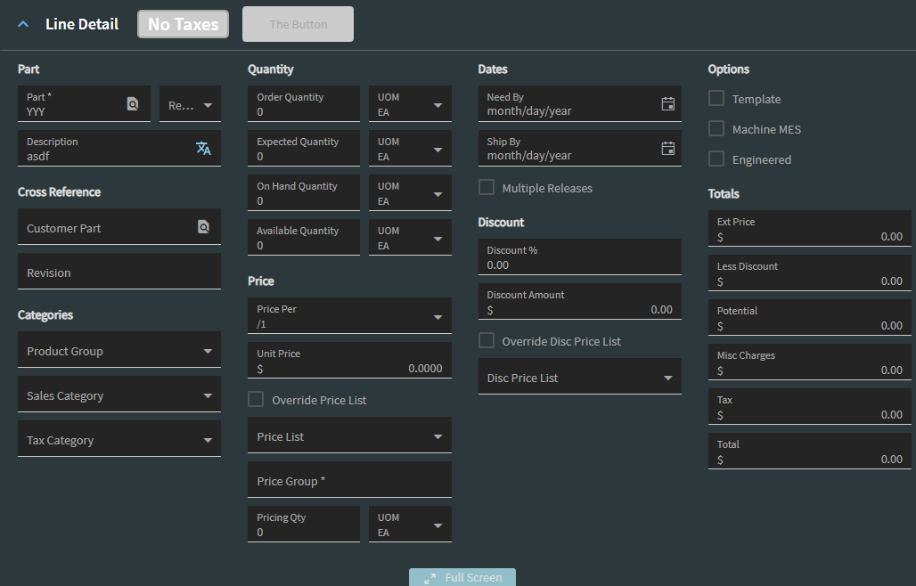

I am probably missing something again, but when i bound the button to “TransView.anything”, it works in tracker. Enabled for one part, not the other.
Yeah, it can be a little confusing. Change your row rule to hide the button if it doesn’t equal “xyz”. Then run both the entry and the tracker menus. The button should be disabled in quote tracker, but I don’t want it to be.
In the example i showed, the button is enabled when the part = XYZ in quote tracker.
Isn’t that what you wanted?
If you bind the button to TransView, it will be enabled by default even in tracker, so I was disabling if for the other cases.:downcast_face_with_sweat:
Oh snap, you’re right. I didn’t read carefully enough yesterday. The key was to use the TransView. Thank you. :slightly_smiling_face:
