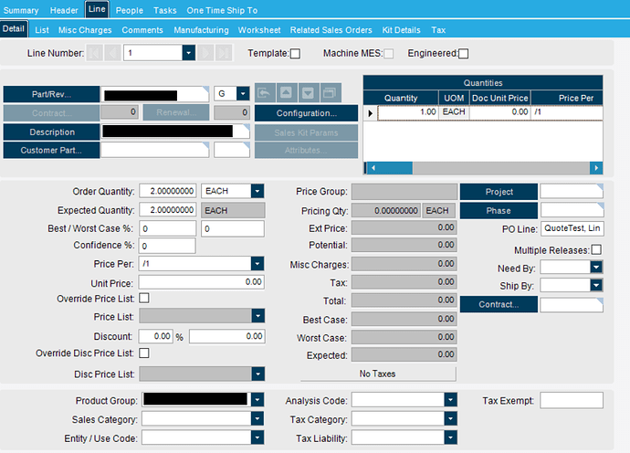

We generally work off of sales orders, and have rarely ever used quotes. I’m trying to get the Quote/Opportunity module set up for our configurable parts, and I keep running into an issue where the Price doesn’t populate correctly (see below):
The configured PartNum (not in partmaster), SellingExpectedQty, and several other fields updated correctly. The QuoteLine Comment is also correct, and it includes the itemized pricing of the configured item. So why is the Price not updating?
