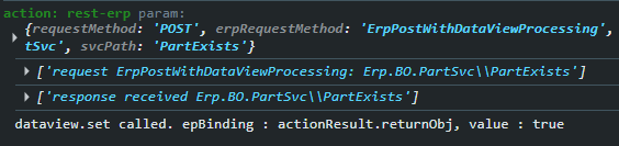

So the rest-kinetic part.partexists seems to almost be the solution, but I am not seeing a way to make the dialog-show action work only if the rest-kinetic action is a failure. The connector to dialog-show only has success, error, and empty. I tried both error and empty, and neither of those seemed to work if the part is not valid.
Looks like the PartExists returns (returnObj) a boolean. Not sure if that boolean value would be stored in the actionResult dataview?? Perhaps you could bounce that off of a condition?
You could also try PartSvc’s GetByID method. That should definitely fail/error if the ID doesn’t exist.
Yeah, the result should comeback in actionResult.returnObj
So, you could use a condition (on success) of the rest call, if actionResult.returnObj is false… dialog show.

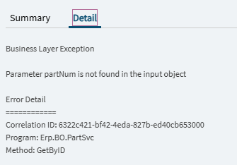

Tried PartSVC GetByID, and that seems to always return an error even if the part is valid. I will try the condition
EDIT:
I should probably post the error
It says it’s missing a parameter. Are you passing the PartNum in as a parameter in your PartExists call?

I totally forgot to put a field value in the method parameters in the rest-kinetic action. That is why it kept erroring!
