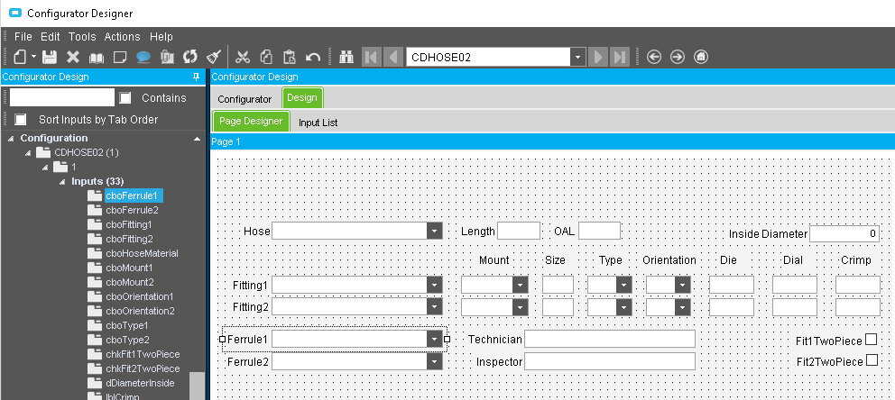

OK so when you open up the dynamic list editor it looks something like this:

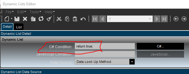

The C# condition is where you do the telling. if you just put
return true;
in there it will always just use that list. if you make two and want to base it off something, say another input value (like a checkbox being true/false) you would write:
if(Inputs.Checkbox1.Value == true) { return true;}
else {return false;}
then in the other
if(Inputs.Checkbox1.Value != true) {return true;}
