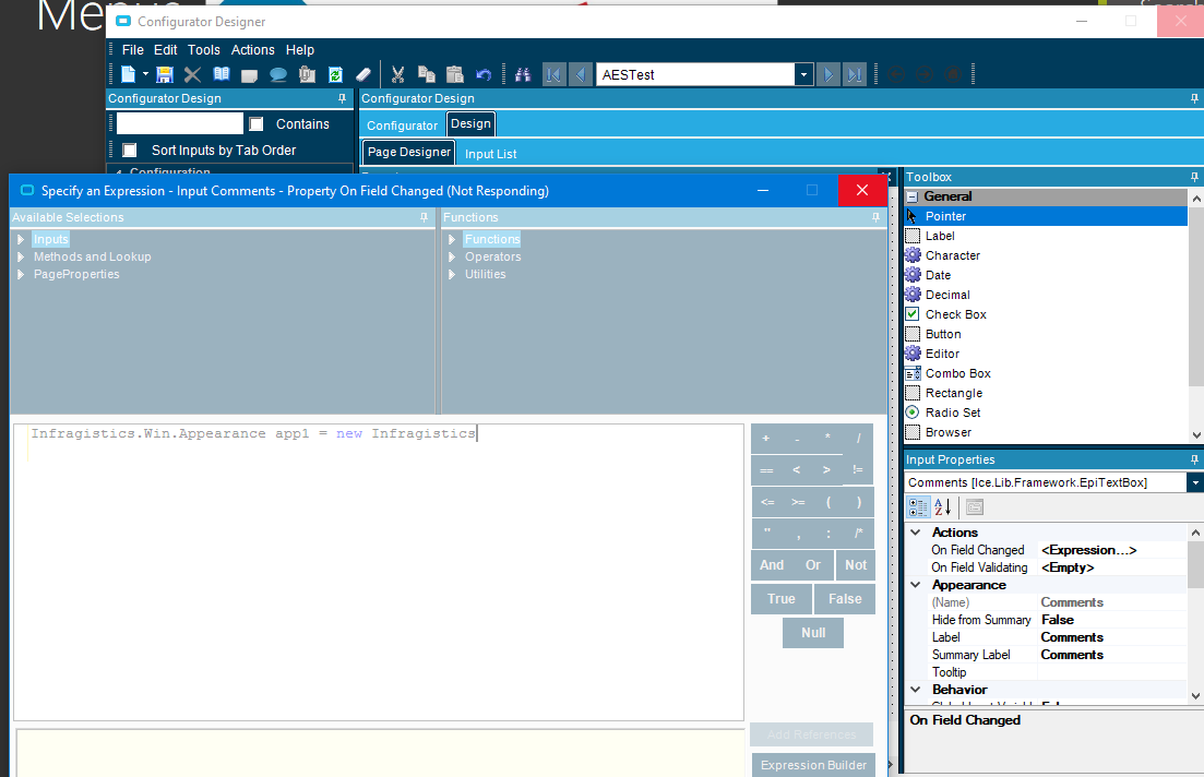

Any idea why Epicor locks up for 5 minute after every time I type “Infragistics” in the expression editor? It it intellisense, and can I turn it off?

I think that I learned from @SAD that the IDE is actually downloading the .dll and then parsing it in order to display auto-complete. It was a nice idea but the implementation is not performant - especially if you’re in the cloud. I would type those out in VSCode and paste them in because typing the ‘.’ is what starts the search.

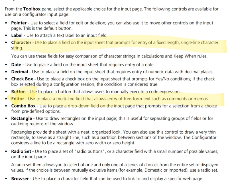

@ckrusen - Thanks! I think that may be it, and the super simple solution. Will check if we used Character, and if so, change it to Editor.
