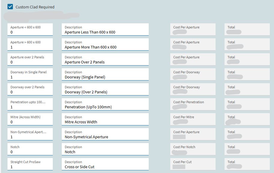

to give some context to this code, in our configurator we have added some fields as in the image below:
the code below will then only fire if the checkbox is ticked, otherwise it stops there
if it is ticked the code will execute and in a breif summary do the following:
  • Look at the quote / order and retreive any misc line charges
  • delete any exitsing misc charges that have the code (in our case) “CC”
  • then look at all the fields in the configurator and see which ones have a value greater than zero
  • write one misc line per charge along with the description
  • sets the prices and frequency

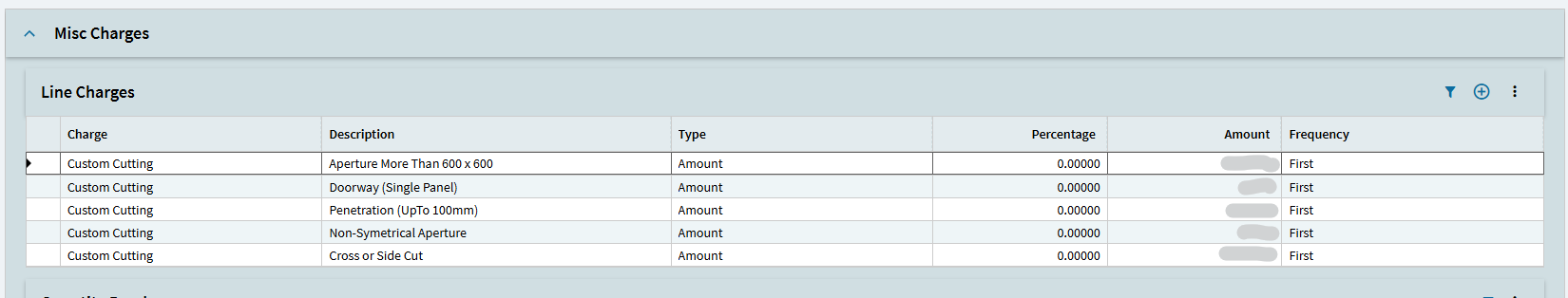

final output looks like the following:
you can then go into the configurator, changes quantities etc and the comments if required and it will remove ALL existing lines with the CC code, then repace with new ones.
