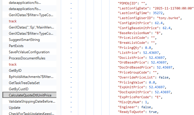

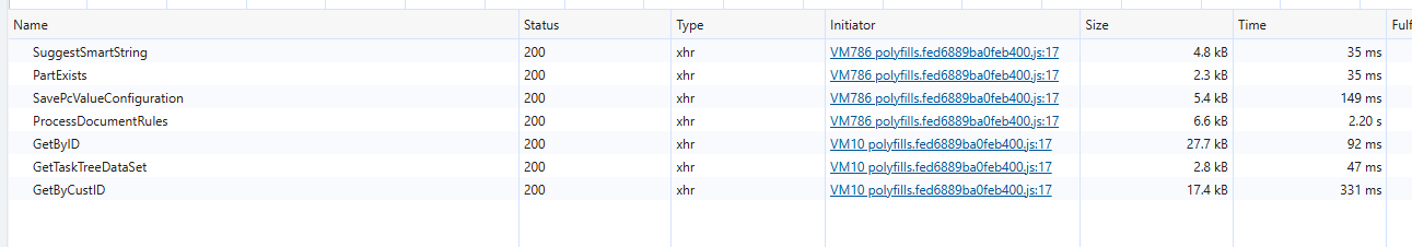

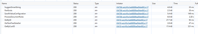

in our PILOT system, the price writes perfectly every time, i have tested it hundreds of times and never had any issues, whatever the total price is in the configurator, when we write the price to the quote or order, it remains the same..
here is a trace from it too showing what is happening on save….this is relevent!
not a lot happens on the save, it just does what it needs to!

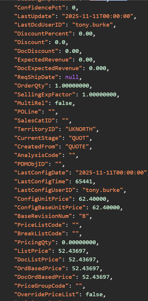

every time we are saving the configurator, the unit price is changing and it is always chaning by the value of our UOM which is 1.19
when i have done the same trace from the same point we can see its doing a calculation…..
i dont want this calculation to happen, i dont know why its happening in LIVE when its not happening in PILOT…..

And you are correct the configurator is pricing at 62.40 and the Live system is then rounding down to 52.43697
This is divided exactly by our UOM which is 1.19…but i dont understand why it is changing it based on the UOM anyway.
