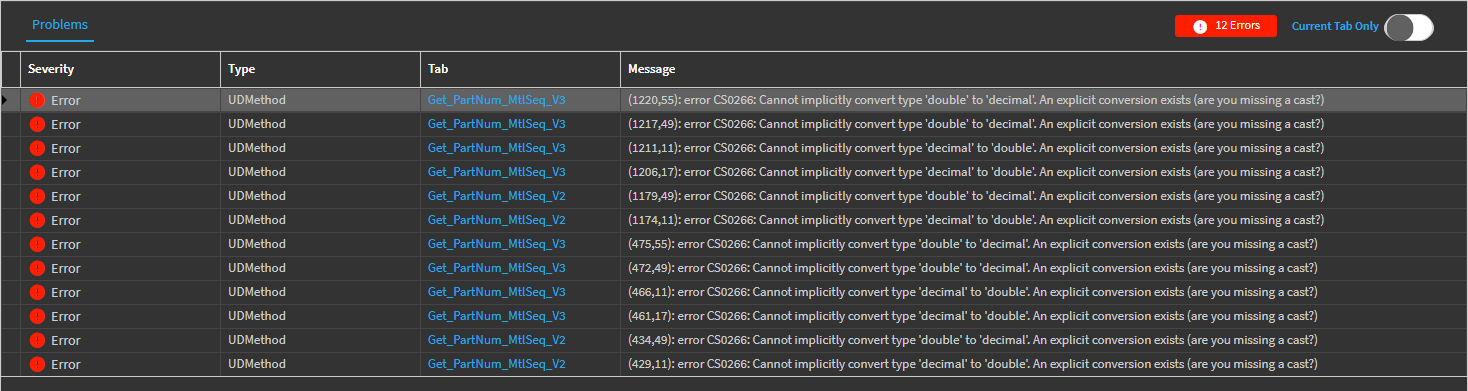

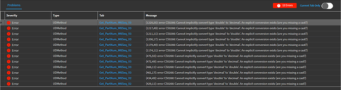

Configurator UD Method - cant convert decimal to double
a UD method on a configurator - before the update you could happily click the check syntax button, find the error and fix it… now you cant!
first error (there are 6)
this to me (based on my limited C# knowledge) the error lies on line 1642 at position 82… (please correct me if i am wrong there!!!
the UD method only has 1500 lines of code
this is all since the update that happened over the weekend.

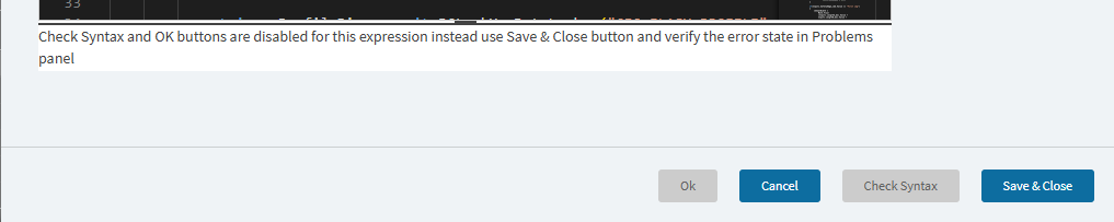

Yeah this is irritating. Since it does a syntax check on “Ok” in the previous version, “Save & Close” now functions the same as “Ok” used to. Weird to disable Check Syntax and Ok instead of removing them, or better yet, just leaving them the way they were.
This has never been accurate in configurators, unfortunately. In the classic editor, you could double-click the line and it would highlight the line with the error. Not sure if that works in the new kinetic editor.

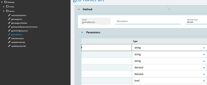

Yes, they made a change to the Configurator in version 2024.2.9 which broke the configurator if you have a client method that calls a server method that has a parameter that’s a decimal (at least that’s what broke for us).
This is the server method that has decimal as parameters:
We then have a client method that calls this and to fix the issue, we had to cast the parameter to double:

I get this suite of buttons when something from outside the method creates the error. e.g. a control is renamed that is referenced in the method.
If I’m editing the method directly, it gives me OK/Check Syntax/Cancel buttons.
