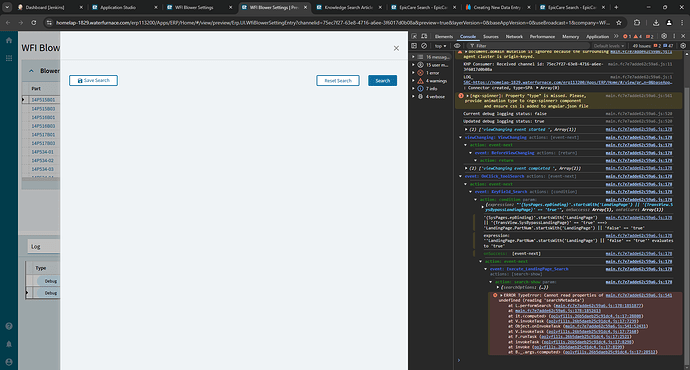

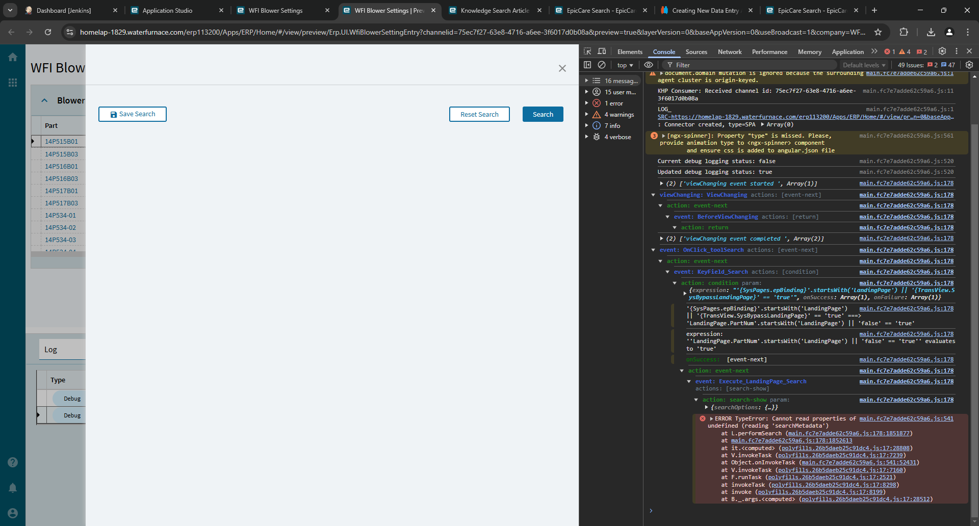

I’ve added a search button to the landing page. The search panel opens, but when I click the Search button, I get a Javascript TypeError:
There appears to be an internal view the search uses that is not being initialized.
Does anybody have ideas on this?

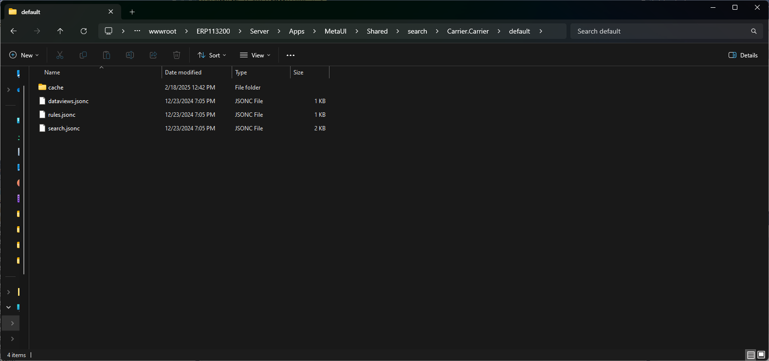

There’s a server-side directory where appears to be where the meta data for all the Kinetic UI components are installed: <>\Server\Apps\MetaUI
The meta data for all of the search panels appears to be stored here:
<>\Server\Apps\MetaUI\Shared\search
Here’s an example of one folder of the built-in searches:
One was created for my custom search, but I noticed that the *.jsonc files were missing.
I copied those files and modified the data in them to use the custom back-end service.
I also updated the file in the cache folder, which appears to be a minified version of the data in other .jsonc files (Is there a way to regenerate this?).
I restarted the app pool on my website and the search now executes and populates the results grid.
