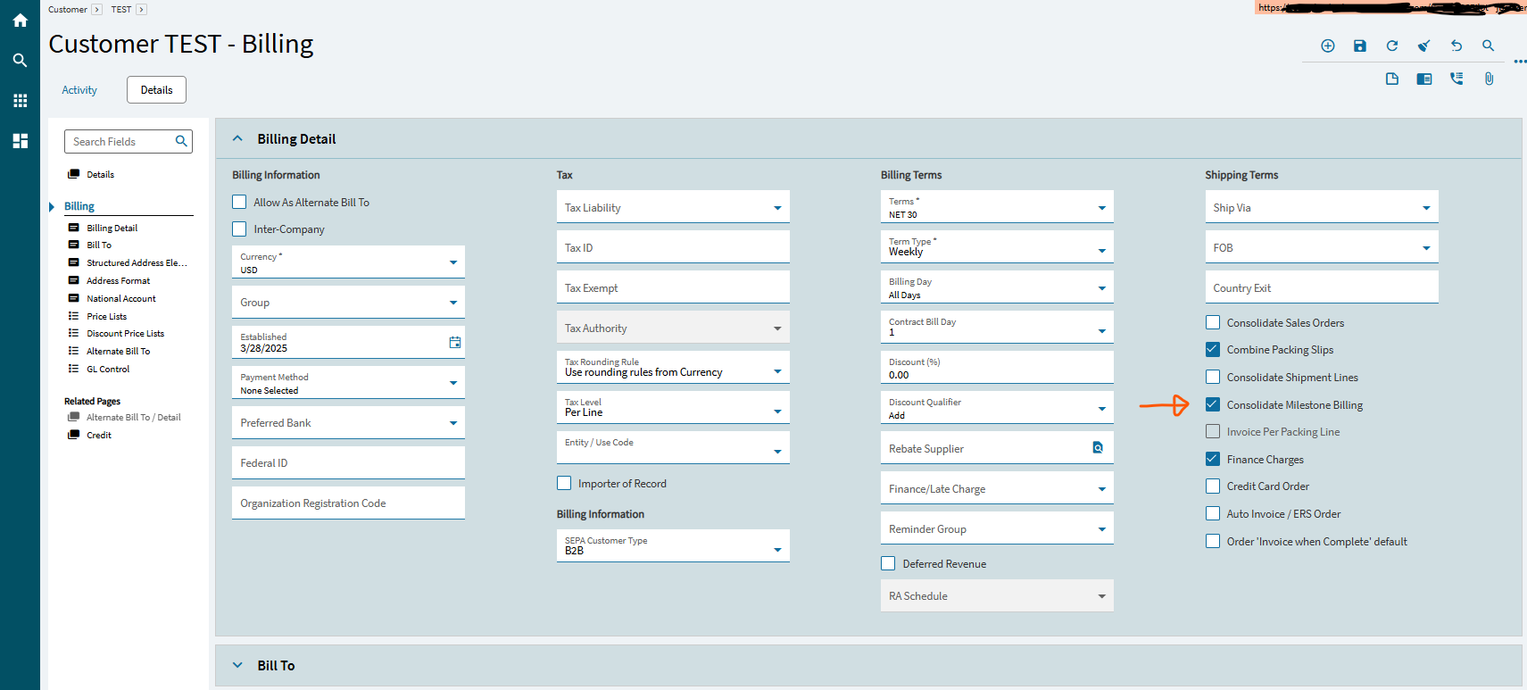

We cannot save any changes to AR Invoice created from Get > Milestone Billing process for a Customer having Consolidate Milestone Billings option active.

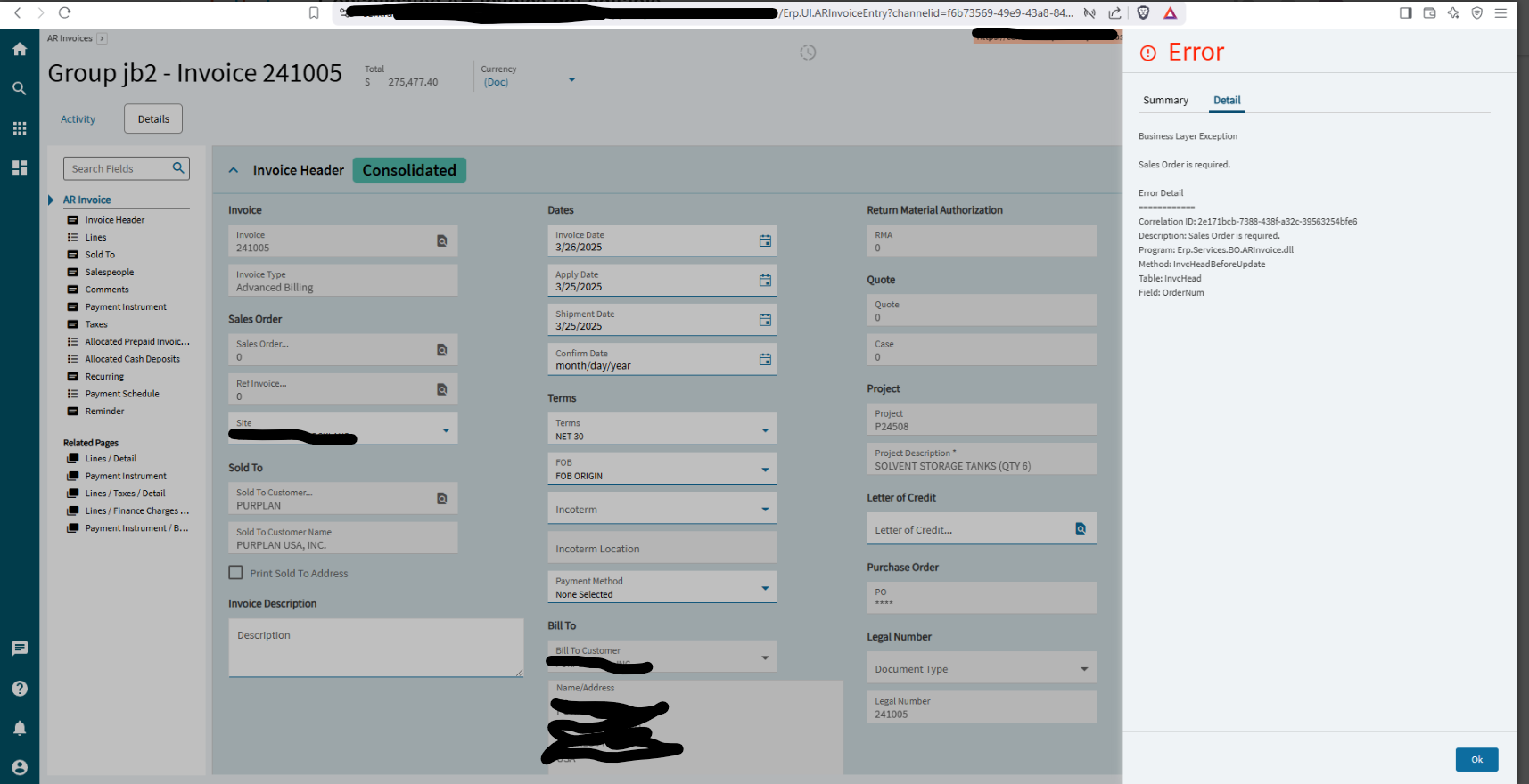

This process results in a consolidated AR Invoice of type ‘Advanced Billing’ having Sales Order Number = zero, thus any attempt to change to the invoice results in the following error:
Business Layer Exception
Sales Order is required.
Error Detail
Correlation ID: 2e171bcb-7388-438f-a32c-39563254bfe6
Description: Sales Order is required.
Program: Erp.Services.BO.ARInvoice.dll
Method: InvcHeadBeforeUpdate
Table: InvcHead
Field: OrderNum
Is this normal behavior or a bug?

I see that the invoice type is Advance Billing… They require a SO number, that’s probably why it is causing and error. You may need to check the billing setup on the related project…
Thanks for your reply. We are using the Consolidate Milestone Billing feature. The resulting invoices seem to have a zero when you bill for multiple milestones.
