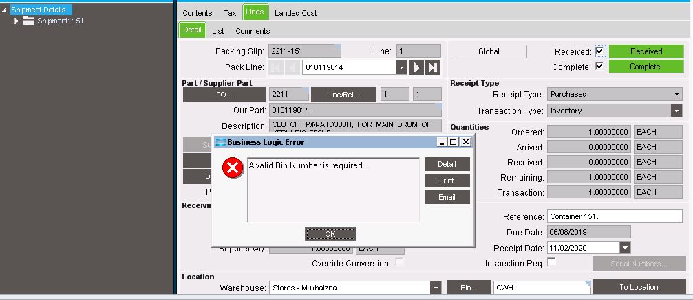

Hello Everyone,
We have been getting this error message on particular Container Receipt Entry. However, a correct warehouse and Bin have been entered in the transaction. We cannot delete the landed cost entry as well. Is this bug from the product? Version is Epicor 10.2.100.6
Hi, We see this quite often but mainly on inspected tranasctions. But check that all your company / site have bins as default. But the screen has problems with the way it loads and transacts data. The other thing we have noticed, if one user is arriving and another user receipts it seems to occur more.
Thank you very much for your help Brychan. Sure, Let me check this out.
Thanks for your help. This is resolved.
