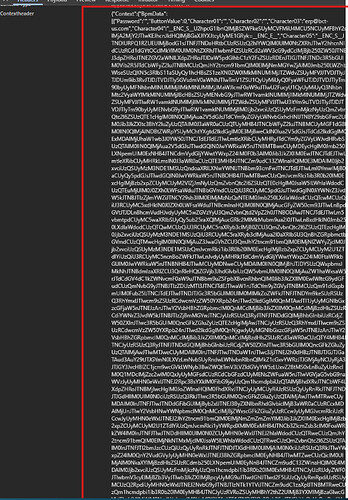

We are web only. I have a shipping notice that fires from a bpm in customer shipment entry. Basically i have a custom code widget that builds an html email, and I jam that string in context data char 05. In version 2025.2.7 and before, this worked fine, but now they are populating all of that data in the header, which causes the ui to bug out. Everything still works, I get the ship notice, but now i get a lovely 404 error in a slideout as well letting me the header is too big.
Before:
After:

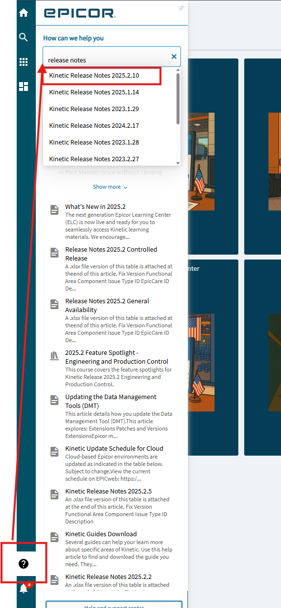

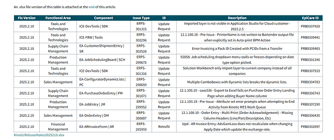

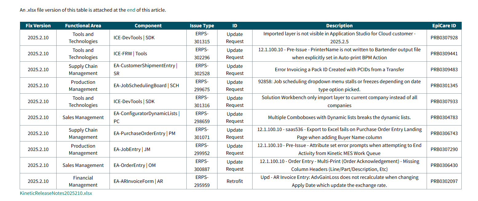

Right here. Everything that has changed in the release should be in the release notes, which we already have access to.

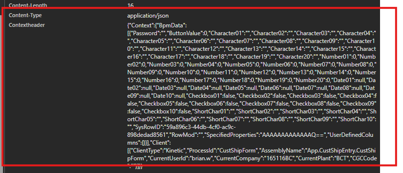

Like @Mark_Wonsil linked to, its always been passed through the header, that part isn’t new. Likely some other change they made slightly increase the amount of information being sent in the header and so then your email body was enough to put you over the limit. So even if it was/is in the change log, it might have required some detailed thinking to realized the side effect it might have.
I disagree, the screenshots above are the exact same BPM firing, the top one on 2025.2.7, the bottom one 2025.2.10

You’re welcome to, but something is wonky. The CallContextBPMData has been in the header since the move to a REST backend, which was a looooonnnggg time ago.
