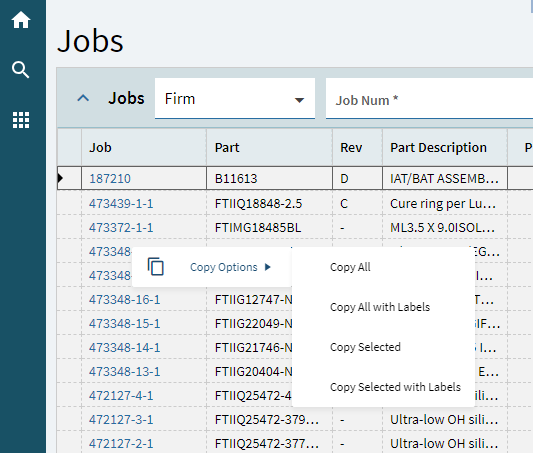

This is such a basic function I’m almost embarrassed to ask why I can’t see where this has gone, or how to get it working again. Searching has come up with a few having issues with custom Context menu items, but nothing like what I’m having where I literally have no “Open With” available in the Client version or Browser version of 2024.2.28. This is all I see in any module when I right click… Desktop client or Web Browser.

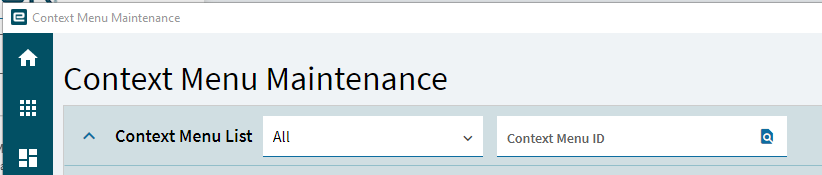

Have you tried using the context menu maintenance?
Should be where you configure specific menus to right clicks on fields

I’m not trying to customize the context menus, I’m trying to see the base ones. Nothing shows when you right click on fields… I can’t “open with” anything.

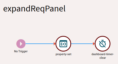

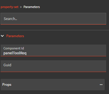

If it does - open a ticket with Epicor about this bug. For a workaround, you can default the panel card grid to expanded = false, then set up a dashboard-timer-set for 50ms, in the timer event, property-set the panel to expanded=true and dashboard-timer-clear.

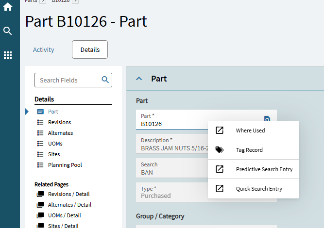

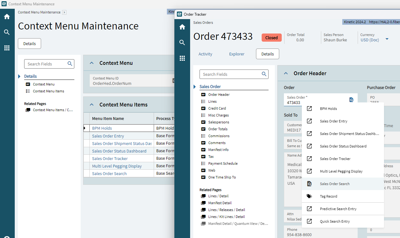

Should have dug just a little deeper… not that this solves the problem… but it shows up for Order Numbers… That Context Maintenance item is listed as “Customize” and not “Base”

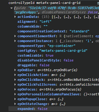

Just curious– what version were you on when you modified the ‘expanded’ property on a Panel Card Grid? Currently on 2023.1.21, modifying that property doesn’t do anything (will change in the component model when debugging but nothing updates in the UI).
I’ve only been able to close/open a normal Panel Card (not a ‘Panel Card Grid’ or ‘Grid’, neither have worked for me).
Good question - I wrote that dashboard around January, so it would have been 2024.1 or 2.
You could try dropping in a panel card, then a container, then a grid (i forgot if you need a container to hold a grid or if it can just go straight in a panel)
Try using f12 dev tools, in the browser with your app open and as the active window, ctrl-alt-8 to turn on debug mode, then ctrl-alt-l to load component model, then switch back to dev tools, find your panel card in the list of components, expand it, double click true in expanded: true and try to set it to false - then click back in the browser window, see if it expands on demand when you do it from dev tools - maybe it’s broken in that version.

The ones that were not working, displayed above, in Context menu maintenance were listed as Base. As noted above too, the only context menu that I was seeing that worked, was on Order related items and that menu was categorized as “Customize” not Base. I’m not sure what was customized about it though.
