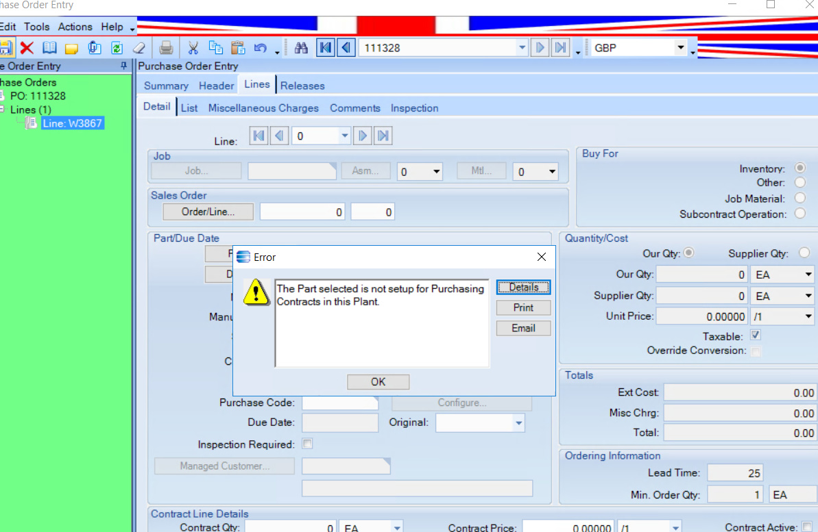

When a user is creating a contracts PO, they get this error…i assume there is a tickbox somewhere but i can’t find it!

There’s nothing on the Part itself, but under Purchase Contracts Management > Setup there is a Part Schedule program that must be set up, and it is plant-specific.
I also remember when I set this up there was a HUGE increase in functionality between 9.05.701 and 9.05.702A… so much so that I actually had to upgrade before the purchase contract module was actually useful in our environment.
