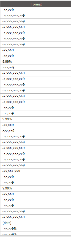

Do you mean making the format on these smaller?
It looks like one of the Calculated field data types does not match with the Data in live.
Try to remove calculated fields one by one and run it, you will get the column has an issue.
