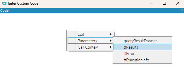

For the first one, you don’t have the ttResults option in the Parameters like below?
I see, they changed it in Kinetic. Use queryResultDataset.Results instead of ttResults. The script below should clear the errors. Can’t promise it will work, but it should clear the errors.
