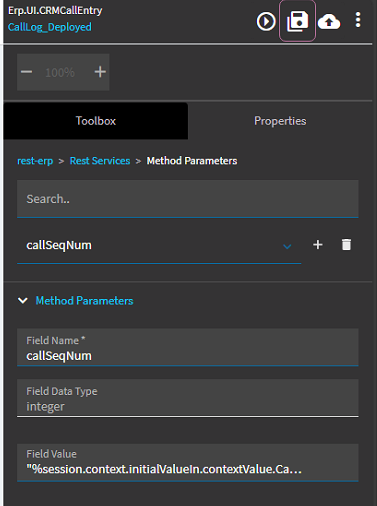

I’m attempting to pass session variables into GetByID method call. Problem is that all of the session variables appear to be strings, and I need to convert one of them to an Integer for the method call to work.
How to convert this to an Int?
“%session.context.initialValueIn.contextValue.CallSeqNum%”
Can you use something like? Not sure about the % being there though.
#'Number({session.context.initialValueIn.contextValue.CallSeqNum})'#
Try not wrapping it with quotes, see if that works

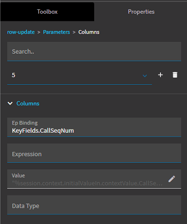

Couldn’t get it work passing the context values into method parameters. I was able to get around it by assigning them directly to the KeyFields dataview with “row-update”.
