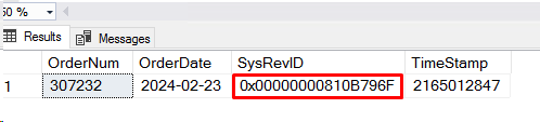

Does anyone know how to convert the SysRevID to DateTime
Data in the Data Base

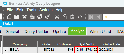

Data in BAQ EPICOR
How can i get 2161574192?
Data in BAQ EPICOR

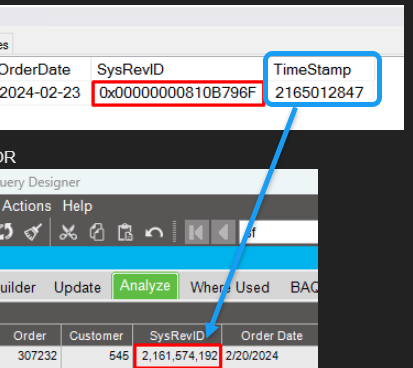

Your timestamp next to the SysRevID looks awfully similar to the number you’re trying to get to.
Well, sure, if you want to do it the eAsY wAy
Yes, but it should come to the same
Yeah I agree. Maybe that’s the timestamp of the printed report as opposed to the time stamp of the last update to the row in the table.

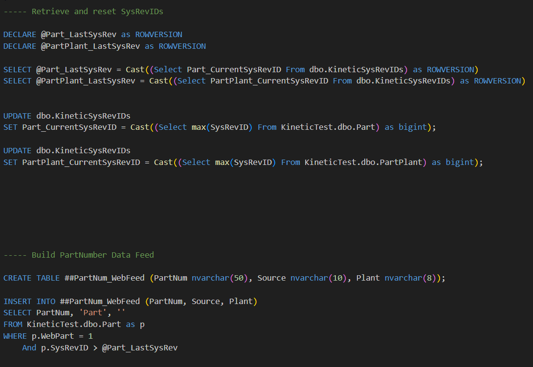

SysRevID is not a timestamp that can be converted to an actual datetime; it’s a SQL Rowversion
rowversion (Transact-SQL) - SQL Server | Microsoft Learn
It tracks “relative time” (not “actual time”) in the sense that you can key off of it to determine the order in which rows were last updated in a table.
It’s useful for integrations if you’re trying to pick up rows last modified since the last time you ran in integration job:
