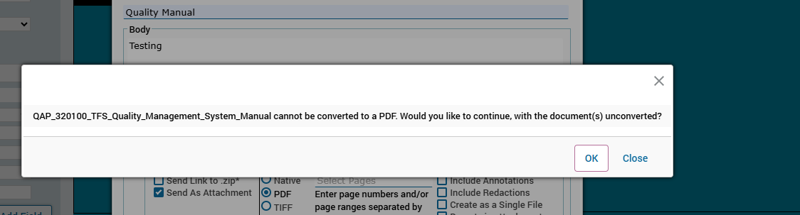

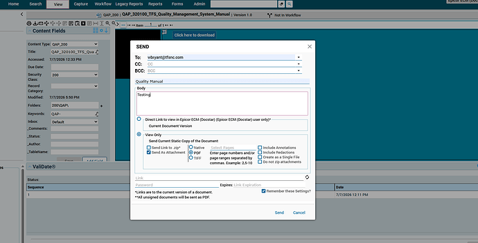

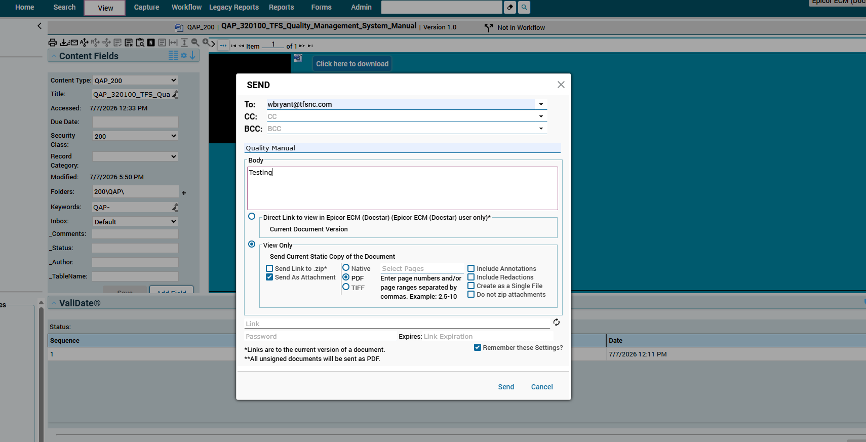

Here’s screenshot of email attempt…

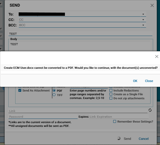

and then with the error I get
Appears to be a limitation of ECM. Tried a cloud instance and it gave a similar error.
It seems odd that ECM would not allow such a basic functionality… especially when the prompts are there indicating that it can be done.
