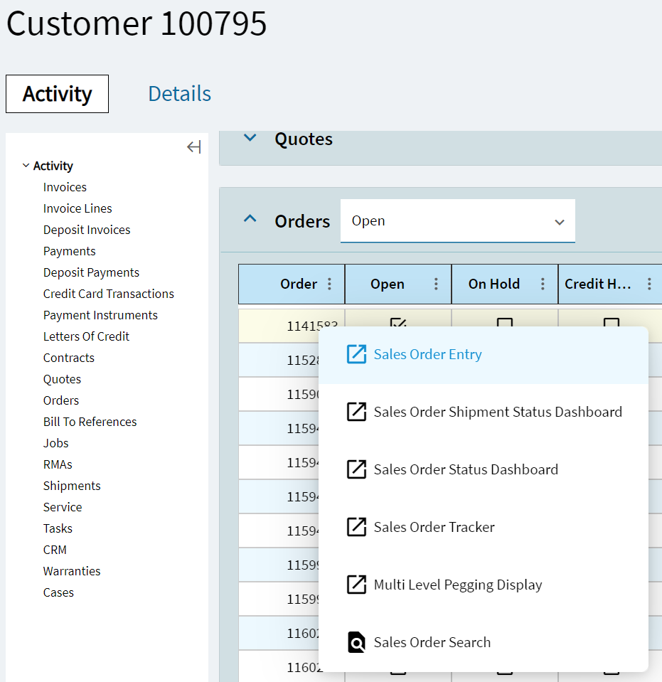

Example, I’m running Time Phase Inquiry. I can right-click on a job and open with various options (Job Entry, Job Tracker, etc.) However, I can’t seem to copy that job number to my clipboard so I can paste somewhere else.
Seems my only option is to run this in classic view?
