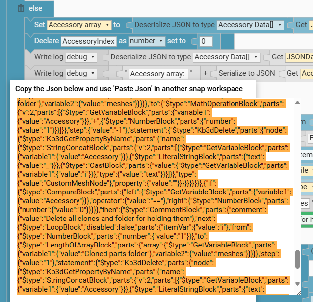

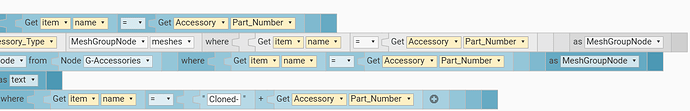

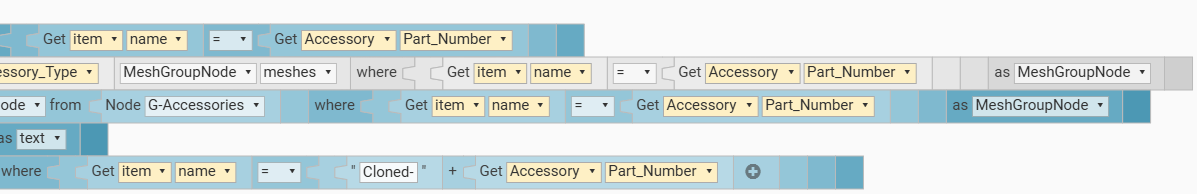

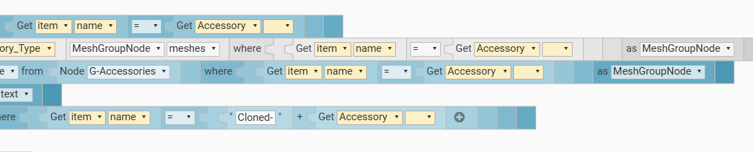

I’ve been updating some snap code to make it more reusable for other parts in my 3D scene but have been running into an issue where copying the JSON of snap code will remove the property of custom types used in the snap code. I know you can ctrl + drag without issue but I was using the right click option to be able to copy into another scene rule. Is there something I’m missing in order to have it copy the snap code fully without losing info? that type is called quite a few times in the code I’m copying which is making it very cumbersome to copy over. Also I’m trying to go from a scene function to a global scene rule so I cannot duplicate the rule itself and drag it into another rule type.

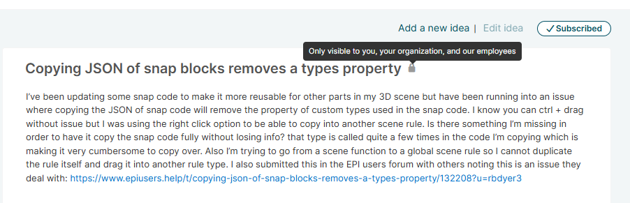

Just added it to the IDEAS portal CPQ-I-364:
CPQ-I-364

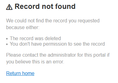

Anyone able to access this Idea link? I waited a while in hopes it just needed time.
Oh thats weird, yeah says its only visible to my org and epicor but its not giving me an option to change it… dont know if im missing something but I tried submitting it again and didnt see any option to select visibility
I don’t remember if the portal tells you if it’s been approved or not, but no one else can see it unless approved.
