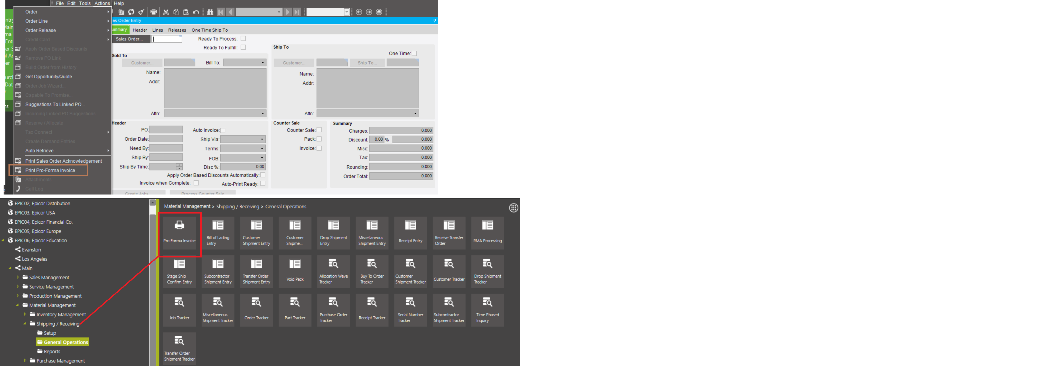

I am trying to copy Print Forma Invoice function from sales order form as a menu item in Shipping/Receiving.
So far this is where I end up
I was able to get the process of the ProForma Invoice and apply it on the created menu item.
Now, next step is to add a filter to somehow enable me to enter a sales order number or add a search function such as a sales order search form. And from there letting the user to print the pro forma invoice from the entered sales order number.
Hopeful here that someone here tried a similar test.
Thank you
You will be better creating this as a BAQ report where you duplicate your proforma. Straight out add a filter and make this menu work will be way more complicated. and the customization will affect the menu on the sales order entry and this new menu you created
I will try that approach Alex.
Thank you for the input.
